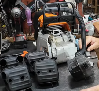

What is common knowledge is that opening up the outlet of a box muffler improves performance. At some point the loss of back-pressure will negatively affect performance, but modern muffler designs attempt to keep charge out of the exhaust, sacrificing performance for emissions.
I suggest perusing his collection - you might just learn something!
You have been perusing his collection a lot, and seem to have come away with very little.

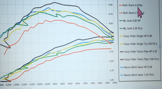

Check out his video where he compares modifications to box mufflers on a Holzfforma G366:
Orange is stock, green is his modification, and the others were modified mufflers sent to him:

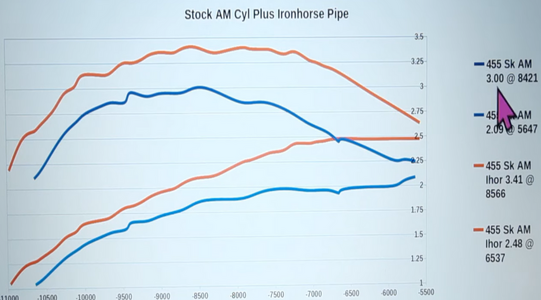

Now, compare those gains to the gain from his magical "Ironhorse" on a Husky 455 (pay attention to the scale on the Y-axis):
3 hp to 3.4 hp with the iron horse (13%), similar to the single opening mods on the box mufflers, and less than the double-opening mod by a lot.
No-one is saying that a "dog dick" wouldn't outperform a stock muffler, just that you could get similar results in a fraction of the time with a stock muffler and a step drill bit.
