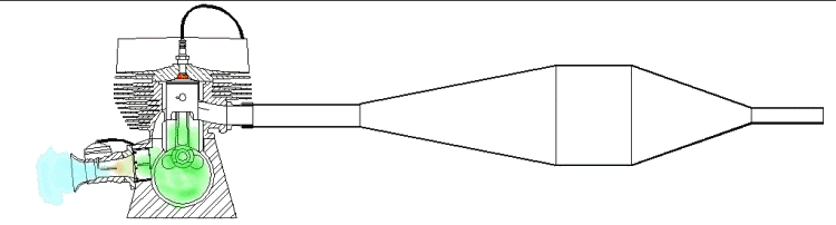

I've been interested in 2-stroke expansion chambers and looking at this animated representation of how they function brought up a question:
That is- wouldn't the modern strato-carb saws have much less benefit from the effect of the expansion chamber pipe? Since those engines at a certain point in the rotation cut off fuel flow introducing only air, wouldn't that then eliminate or seriously reduce the power-gain from the pipe?
Its worth a thought anyways, perhaps the point the expansion chamber is sorta sucking the fuel through is different from what point the strato bit cuts fuel-mix but I'd think its quite possible that the strato would kinda interfere with optimal function..
builders do not build piped race saw with the strato ports and there is almost no result by butting a pipe on a stock chainsaw
My understanding is that the strato loads the "front" of the transfer with air so that you can time the engine to push out more exhaust without throwing fuel into the exhaust port. Better scavenging without wasting fuel.
The first wave with a pipe (created by the diameter of the pipe increasing) creates negative pressure that draws more charge through the cylinder into the exhaust, which would improve scavenging, but toss away fuel.
I think that the real advantage of the expansion chamber is the positive wave created by the restriction at the end of the chamber. This stuffs that fuel in the exhaust back into the cylinder. That compression of the charge allows more air and fuel in the cylinder; it is basically supercharging.
I don't see how a strato design would interfere with either process, but I could be missing something. I've never had a strato saw in my hands.

Interesting idea...
I have never built an expansion chamber (so take this with several grains of salt), but I have done a lot of research into how to do so.
The design in the video relies entirely on back pressure to minimize fuel loss. I don't see it being any different to "cut and try" in terms of common muffler mods for chainsaws. The reason that expansion chambers are so large is because it is the timing of the reflected waves that matter, and that depends on exhaust speed.
An opening of the exhaust into the chamber causes a reflected wave of negative pressure. That has to occur at the right time to pull more charge from the crankcase. The cone (as opposed to an abrupt opening) widens that timing window a little.
At the opposite end of the chamber, the restriction reflects a positive pressure wave. That's what stuffs the charge that was pulled into the exhaust back into the cylinder. If his cone was reflecting positive waves, they would occur way too early, which would be counterproductive.
The only way to make a shorter expansion chamber exhaust is to find a way to speed up the waves. Higher temps would do it, but not enough to make that much of a difference in length.
