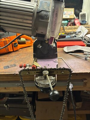

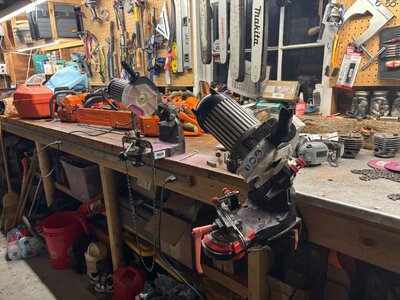

I can’t believe that I haven’t used a grinder for rakers until now. The hours that I’ve wasted… and the worst part is that I already owned the second grinder! But I just never got around to setting it up.

Have you cut with one of those chains yet? I find rakers on the grinder to be a tricky business and not that bad to just hit them each a stroke with the file.
I hear you about being a little tricky. Takes a very consistent technique or they will be all over the place. I shaped my wheel with a single point diamond dresser to keep the profile close to factory.
I haven’t yet. I set the height by first filing a tooth with my progressive raker gauge, and then adjusting the wheel height to that raker.
I was initially skeptical about my ability to be repeatably accurate with the grinding, so I went back and hand checked the rakers with my flat file and gauge. They were all within a swipe or dead on.
I have been liking to use the progressive gauge to file my chains lately, but have found that due to the slanting angle of the filed area, a lot of material needs to be removed from a new chain to begin with using the gauge. Most of the chain that I run is 84dl full comp, so that means 10-15 swipes for 42 rakers, which can take over 20 minutes. Now I can do it in like 3 minutes.
