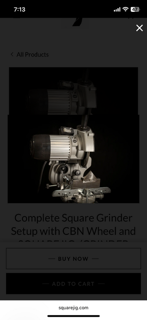

I have an Oregon 520 grinder but that pic is jug from the guys site to give you and idea…damn thing works great and he makes them on the side….i got the cbn wheel and the 45 degree jig….works way better than the silvey 450 I got….and I’m not new to grinders I have the Oregon 520, Stihl usg (cbn wheels for all), and the silvey 450 a few months ago (haven’t spent to much time with her yet)….but the square jig does as good of a chain as I have seen with any high dollar square grinder…
I do my 3/8 and .325 chain on it and I love it….i used to sharpen the public’s chains so all my grinders and cbn wheels were paid for in profit….so if i remember correctly it was 300 or so for the jig and cbn wheel…I love it!!!
I move the chain stop forward slightly and grind again on 3/8 chain when
I use the 325, cbn wheel to get the gullet so to speak

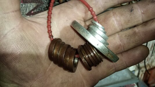

First thing I noticed was that moving from a left hand cutter to a right hand, I need to make a big adjustment to my chain stop. Otherwise the right cutter gets a lot shorter. Oops. (That one being short wont hurt anything....) I'm sure Ill figure out the best approach after some more usage.
My AMA Maxx does that too.
I made a (thinner) custom contact/pressure plate and shims of various thicknesses.
To approximately center the grinding wheel to the LH & RH cutters it takes different shimming depending on the wheel thickness.
In the time it takes to do all that @hacskaroly can have 1 tooth filed.
8:02 AM
14,985
59,762
I made the contact plate and shims just to see if they would fix the tooth length issue.
They do.
I don't bother using them, I simply adjust the cutter stop accordingly.
Are you talking about round ground chains or using the square jig???

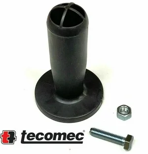

Got a picture?
There have been different handles used though the years.
Thanks.
Philbert
I'm not currently near my grinder, but the handle on it is just like this one... (stolen from an eBay listing)
I think part of it is that the plastic just cuts its own threads as you put it on the bolt, and that doesn't feel super firm. But its also not quite as long as I would like, and after playing around with it for a while, it wasnt feeling good in the hand.
I guess that’s the style I use. Never bothered me. Some of the clone grinders used to have a ball-on-a-stick style handle.
Some versions have a hole in the base to run to a foot pedal!
We have a surplus store near me where I shop for weird handles, etc,, but anything with that thread will work.
Or, you can put a thread insert into a wooden handle, wrap the current one with tape / foam / etc., if you want a different shape.
