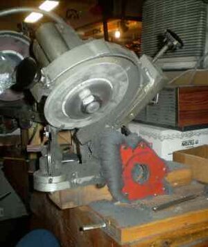

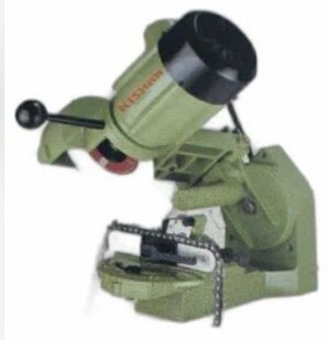

Some of the clone grinders used to have a ball-on-a-stick style handle.
After I posted that, I searched and could not find any images of these older style handles (!).
Everyone seems to be using, or copying, the plastic handle shown above.
Finally gound this one (in India), just for illustration:

I guess that’s the style I use. Never bothered me. Some of the clone grinders used to have a ball-on-a-stick style handle.
Some versions have a hole in the base to run to a foot pedal!
We have a surplus store near me where I shop for weird handles, etc,, but anything with that thread will work.
Or, you can put a thread insert into a wooden handle, wrap the current one with tape / foam / etc., if you want a different shape.

Part of me thinks the ball on a stick handle might be the way to go. Maybe its just the height of my workbench and me standing while grinding, and I need to get a stool or find a new place to mount the grinder. Or Ill just have to try and find something that seems like its going to bolt up and feel better. Appreciate the input/help!

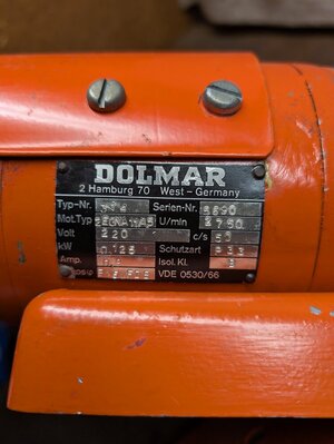

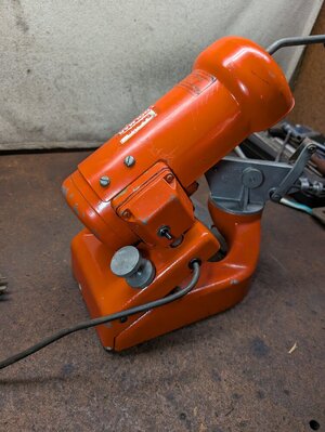

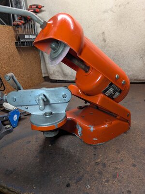

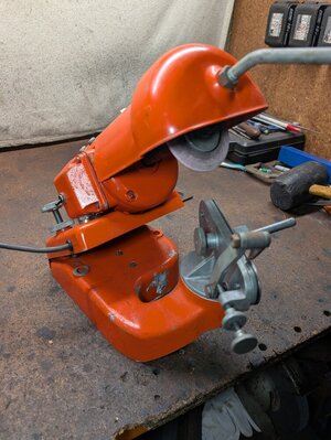

Picked up this old Dolmar grinder last week. Does anybody know anything about them?
USG wheels seem to fit it. Only has 35 degree marks on the base for rotation and has to be the heaviest dam grinder I have picked up

These grinders were built from 1966 to 1980 and distributed worldwide. This machine was produced before 1969 (because DOLMAR move from Hamburg 70). Therefore the SACHS-DOLMAR sticker is not original, because the name changed in 1975 (=> Fichtel+Sachs)
Rolf Lehmann (DOLMAR Service- and Productmanagement 1984 to 2014)

Thanks! That is a lot more information than I have been able to find so far. Hopefully I can find a catalogue that showed them from that era
I'm in the process of moving house but I will make a video of it in action in the next few weeks
