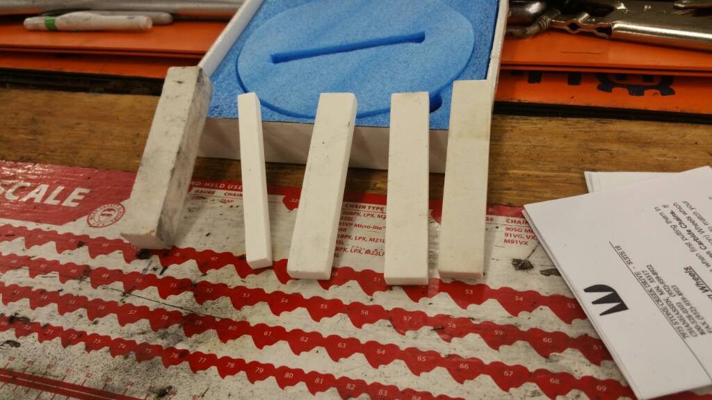

On the diamond wheel website they say they send the wheel with a cleaning stick to use periodically. What does that look like?
Look at that white stick in top of pic... it's a square white ceramic type stone....I will get closer pic for you guys tomorrow....
Also their is directions on how to clean wheel, and I will take a pic of the whole page for you guys....
I will say these guys take pride in their work which is very nice... was boxed up very nice and tight.... and the cleaning stick and directions!!!!

Little white sticks. Have not used one yet. Even come with diamond wheels.

To any of you guys with CBN wheels, how often do you use the "dressing" stick.... in the directions they dont give an excact number of chains, they just say when you start to notice a burr or the wheel not cutting as good to dress it...
Also they say to flip the wheel every 20-30 chains....
What do you guys that own CBN wheels do???
Never and never. I don't think mine came with any directions.
Sent from my SM-N900P using Tapatalk
Hey thanks!!!
Yes, they packaged this wheel very nicely....it came with the white dressing stick, and some directions, I will take a pic of the directions if I remember next time I in the garage....
I do remember it saying to flip the wheel every 20-30 chains to ensure equal wear(if you can call it wear), and to use the stick to clean the wheel eventually(if ever needed!!!)
Is the wheel you have from diamond wheel brand?????

Hey thanks!!!
Yes
