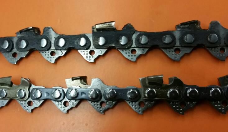

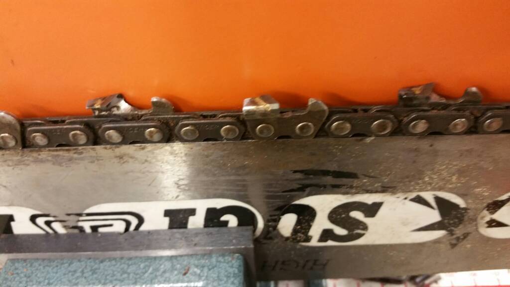

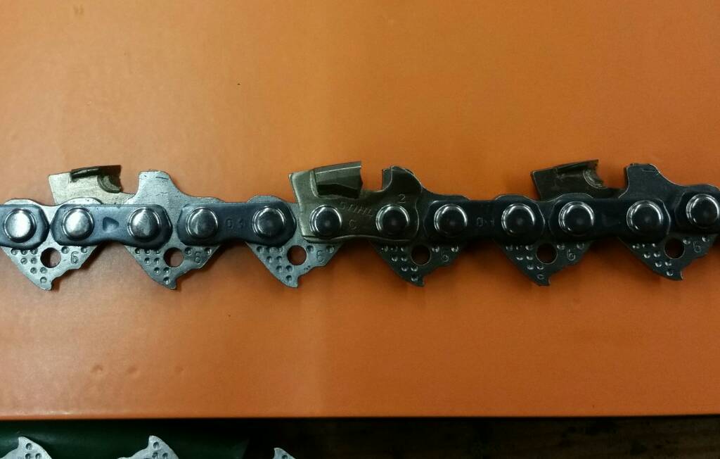

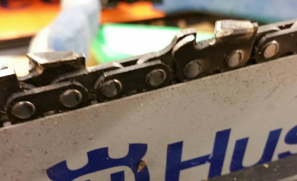

Carbide pictures. The angle on box says 75 degree for top plate. Plus a 15 degree offset. I can only do that much offset on my 620 grinder. The 511ax only does 10.

Hey thanks a lot, that stuff is very strange looking!!!!
