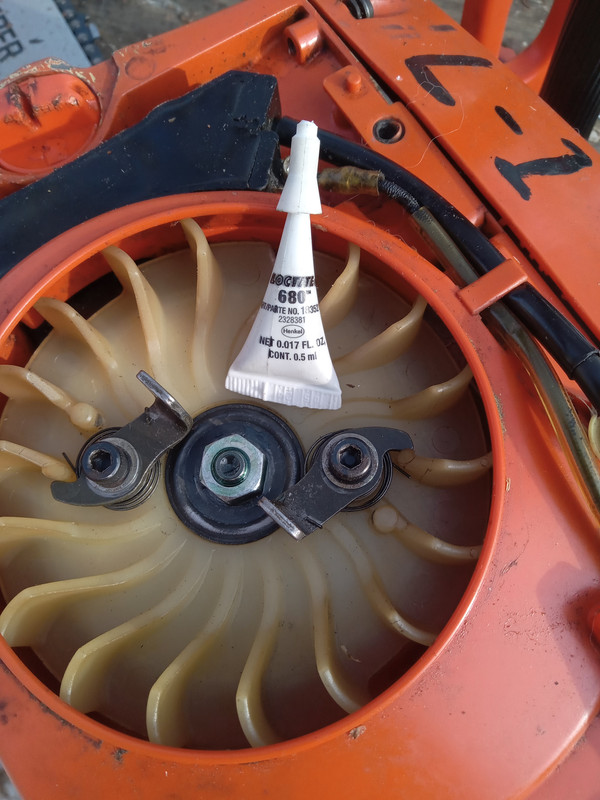

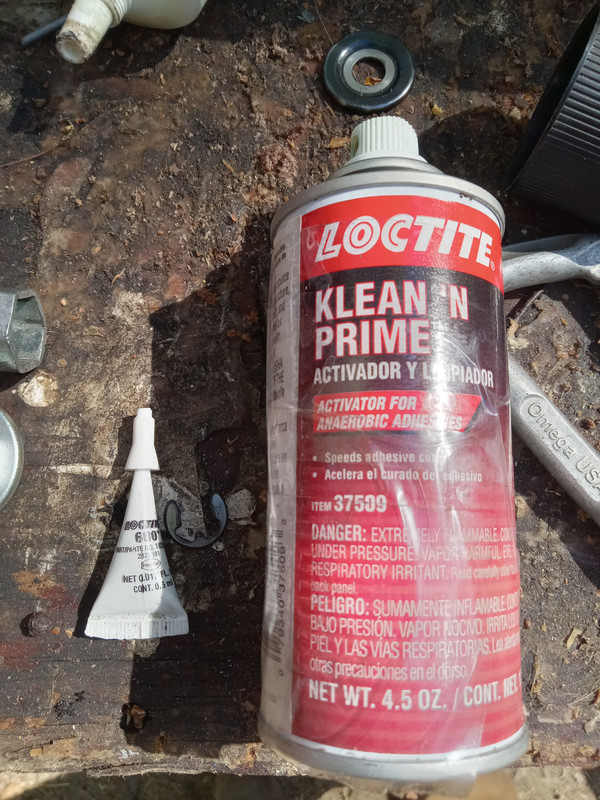

Have had the nightmares of clutches, flywheels and muffler bolts that would rattle loose, no matter how clean the threads, or how tightly they were cinched down.
In all instances, loctite 680 retaining compound fixed the problem, permanently. No amount of extreme heat or vibration or exposure to oil will rattle loose loctite 680.......
