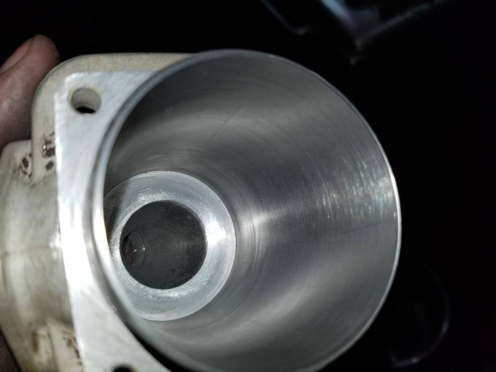

Looking at the pictures he has the equipment to bore it and sleeve it.
Like this.
Red97
5:19 PM
385
Jan 2, 2016
7,497
54,168
MI
Don't get me Started!
LOL
A 54mm would be a squeeze FOR SURE.
Cases aren't very thick Walled.
What would I need for a Cylinder?
What's the Stroke?
Try boring the 272 jug for an iron sleeve. I'd try to keep .060 wall minimum. .080" would be ideal.
Run a stihl 066 piston.
