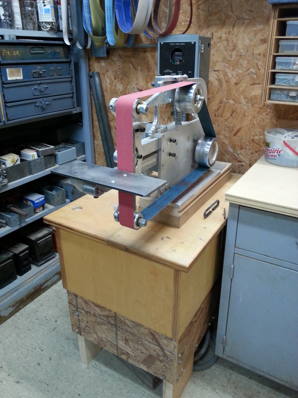

I use my 2x72 grinder on most everything.
[/url][/IMG]
If I had one of those I'd use it for about everything too.
