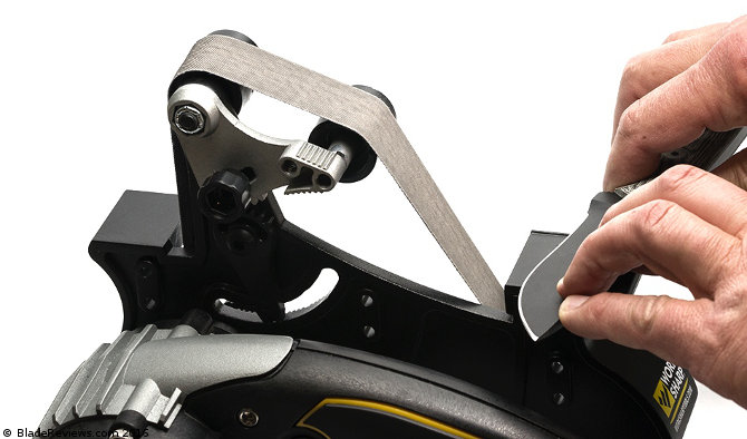

I use the Ken Onion Work Sharp with blade grinding attachment. Pricey but well worth the money. You could get the same results with a Harbor Freight 1" belt sander at less than half the price of the Work Sharp. All the belt sharpeners put a convex grind on the edge which is more durable than a standard V grind.
I'd been meaning to show a what the edge looks like after sharpening with the Work Sharp. It doesn't take long to get a shaving sharp edge.
