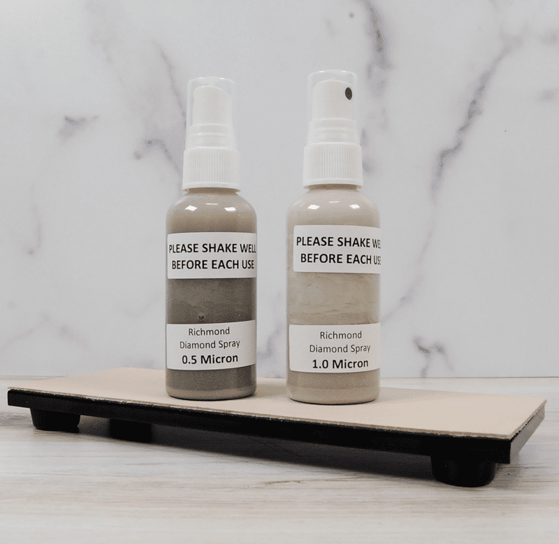

To keep my knives honed use a ceramic honing rod and a flax linen strop followed by a cut through a hard felt block. If I need a bit more touch up, I’ll use CBN spray on a strop. The strip is a niece of float glass with balsa wood glued to the surface. On top of the balsa I use leather with the felted side out. The balsa will compress slightly giving a slight convex profile to the edge. It removes the wire edge and the slight convex is very durable.
Once this process no longer revives the edge, it’s back to the beginning.
