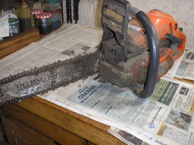

I received a 0-compression Husky 550 XP yesterday that has to have a new top end. Piston ring no longer exists and the groove for the ring cannot be seen. Based on this thread, I ordered a new top end and will try to restore the saw. Here's what the owner brought in:
Lord knows what else I will run into, but a new top end is a must. My work is cut out for me. Thanks, forum.
