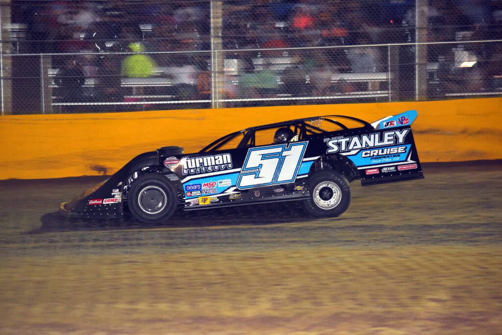

Love it when talented machinist and car chiefs share their thoughts. Keep this thread going guys. In your scenario Shaun both hats fit you well. So on a late model or modified the extended tail sections of the side panels have dual purposes? Both to catch the air into the turn and also reduce the low pressure area on the rear? Interesting.:private::private:
4:25 AM
4,209
27,566
Do you mean the spoiler sides?

We played around with our spoilers on our race cars... angles, heights and we even angled our spoiler in the sense that the RR spoiler had a lesser degree than left side... in my mind, it changed the downforce on the rear section of the Decking...
It would have lessened the downforce on the right side of the deck some and maybe decreased the drag.
Here is about the only published cfd results for dirt cars, notice the name on the nose!
