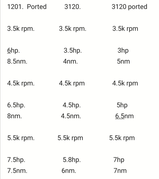

That saw was built for tq, hp gain is a by product from mod work. With 72" b&c rpm should sit somewhere between 4k to 6k range in milling im guessing?
Here's an educated guess of what happens "behind" the dyno
After about 7k rpm mark 1201 loses steam and tend to lose to the other ported big saws. If the cutting rpm stays below that range, 1201 will hold its power. At about 4.5k rpm mark 1201 has tq of 2 stock 395xp

That's pretty much how all of the Echo motors are, especially the older ones. They make peak torque at a lower RPM range and it usually has a large band.
In fact, most Japanese-designed two-strokes are that way. We had an old Hodaka Combat Wombat when I was kid and it liked to climb hills and didn't need high revs to do it.
You nailed it jj
