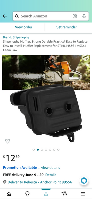

Years ago there was an AM muffler that was just an empty can, that I bought off Amazon. I don't know who made it or if they even make it anymore but it was definitely an easy upgrade.

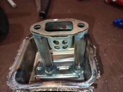

That would be nice. I know the ones that come in the FT parts kit have that stupid baffle inside.
Though not an empty can this aftermarket muffler has much less "guts" than the OEM style. A drill or rotary bur could remove the small baffle WITHOUT separating the two halves.
