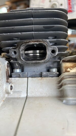

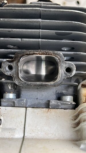

Dumb question, but in the muffler, can the gains be had by drilling out a larger hole(s) in the baffle from the exhaust flange side? Like say knocking a 3/4” hole in the end of the “box” and maybe a few more 1/2” holes around the sides?
One could, but there are a host of problems.
The muffler inlet is about 4mm smaller than the heat shield/gasket/exhaust port (in my case at least) for the entire perimeter. So around 8mm narrower and shorter. The baffle is right up against it, so it is difficult/Impossible to open the inlet with the baffle there.
In the JMS redo that led me using the numbers in this build, he knocked the entire deflector down and left it in the can. It eventually came loose and vibrated/clanked in the can. I cut the muffler apart and took it out. In retrospect, it might be easier to bandsaw the muffler apart and braze it back together vs the whole uncrimping/recrimping process.
Just drilling holes creates another big issue, metal dust stuck in the muffler. You can rinse and clean as much as possible, but you always run the risk of some being left in the can. That can find its way into the business end of the saw which is never good.
Great points, thanks for the input.

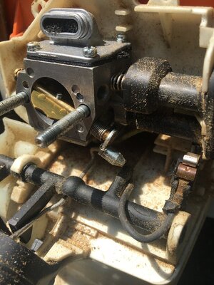

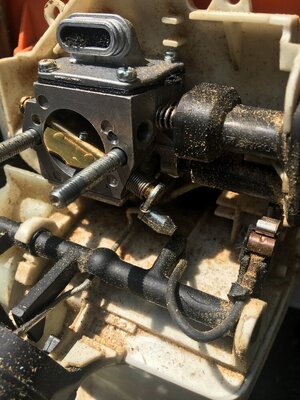

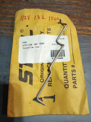

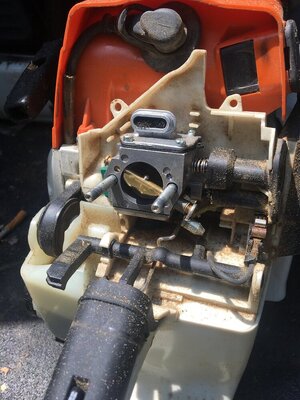

Does it work? Do you have bent the end? Plug and play?
I had one on my bench because an older builder told me it would work. He also told me that an 1122 impulse was the way to go. The 1122 impulse was too short for certain and I couldn’t get the 1128 rod to work.
It seems like the PTO side of the trigger won’t retain the shaft Steve. The saw is boxed up at this point. I’ll pull saw and install if this works without issue.
Thank you.
Thank you.
Well... as you can see I haven't put that in yet. I ended up making the last 361 I did a work saw with standard carb.
I'm not the originator here either, this idea came to me via @dall as it is what he put on his saw when he converted to the 440/460 carburetor. I bet he will elaborate for you to get a good idea, if not I have the stuff here I can mock one up and let you know.

I had to bend the section between the choke lever and the rear handle to shorten the length but that’s the only place
