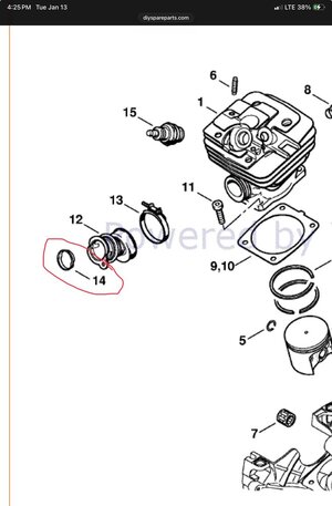

This makes sense that the fuel was spit back and not leakage through the carb. The inner ring is for sure still on the boot?
EFSM
9:09 PM
29079
Apr 30, 2024
1,600
3,952
Extreme southern IL
Yep, inner ring still there, and the outer one.
I worked on a Stihl 192 that had a deformed boot lip due to the outer ring not being lined up properly during prior carburetor work and it wouldn’t seal right. It sounds like something similar may have happened here. Glad to see you sorted it out.
