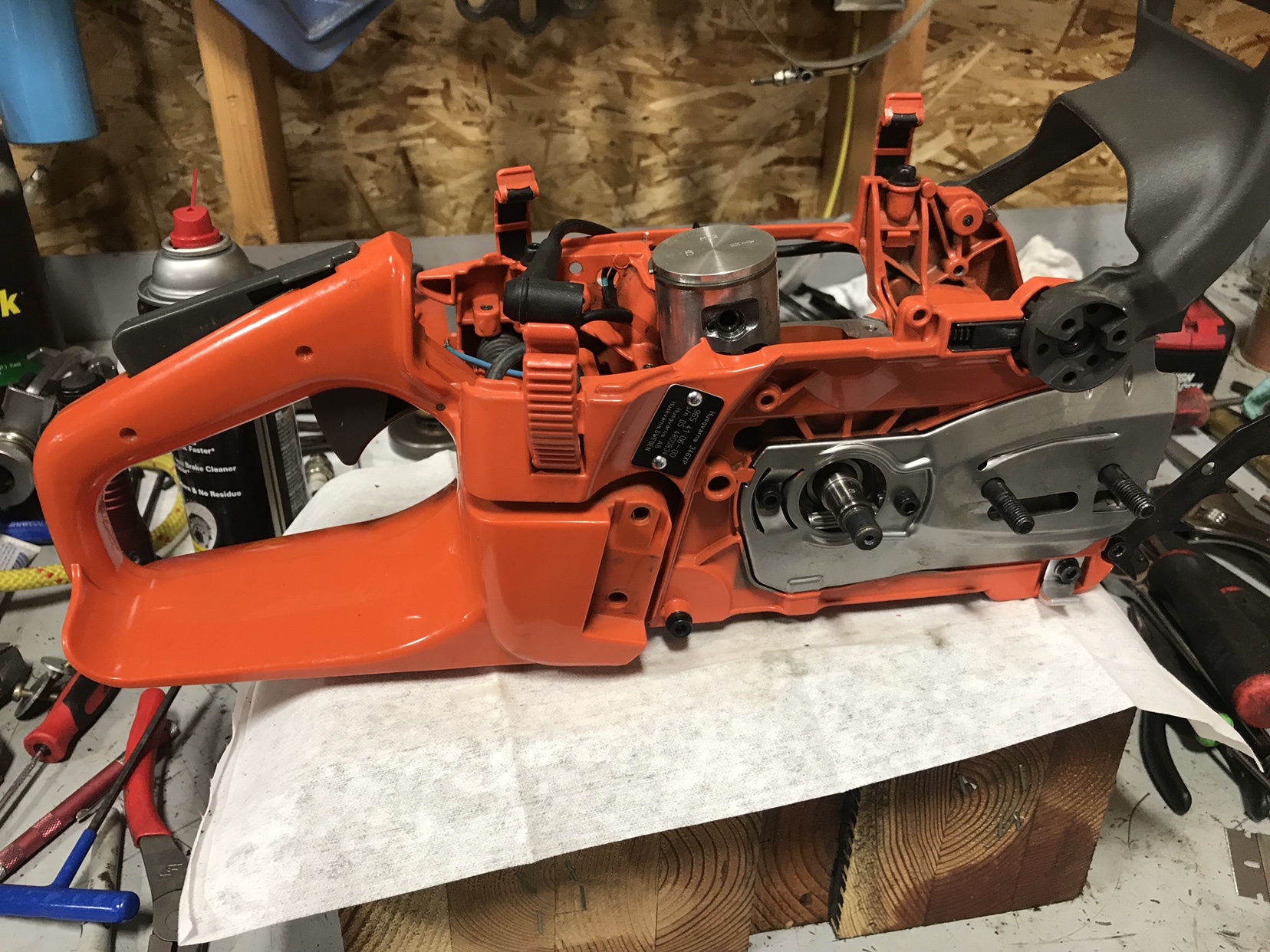

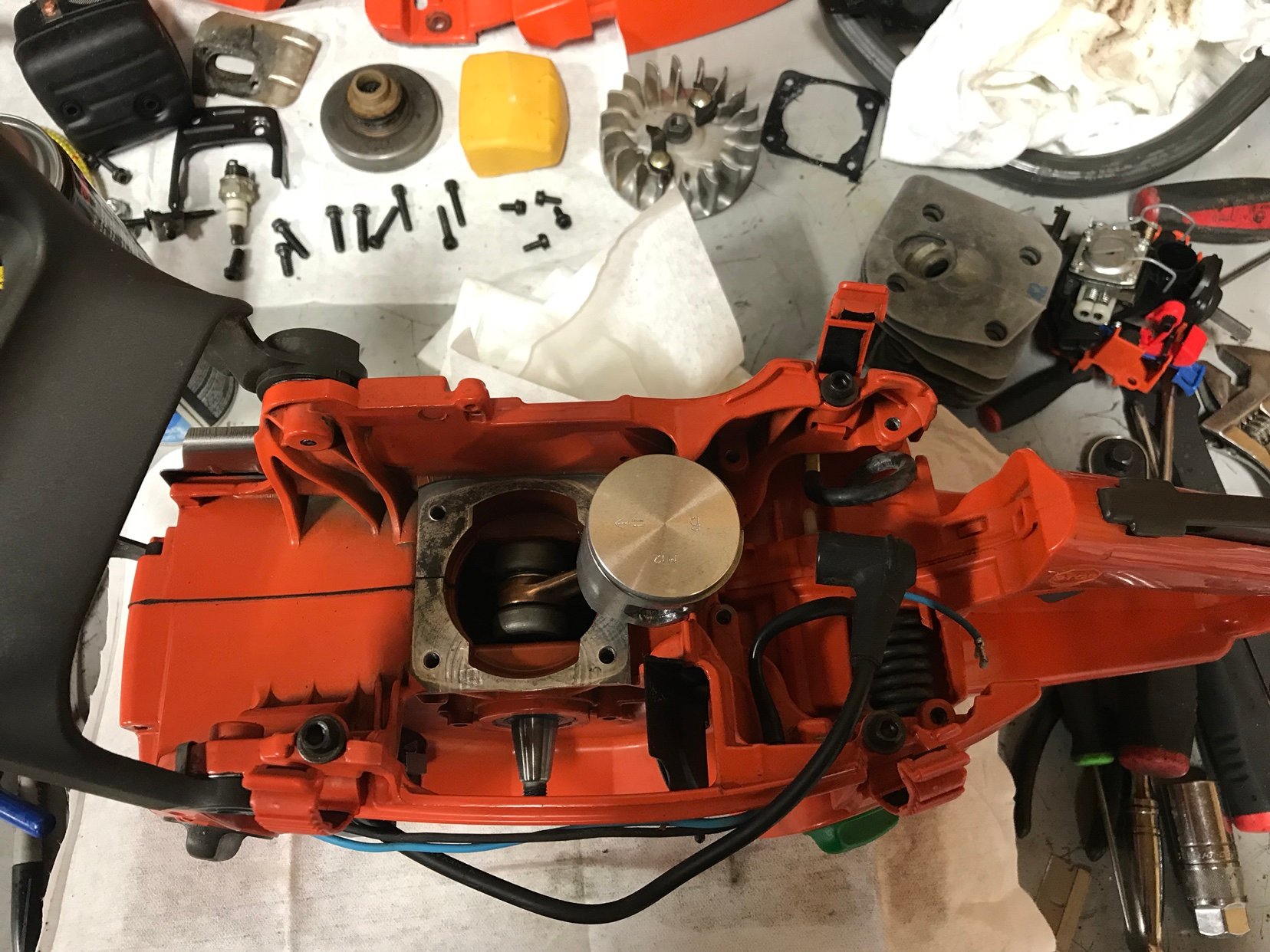

Someone cleaned that cylinder up quick and added a meteor. A few points:
That’s a loss of plating. See the coarse scrathes in the plating below the Ex floor? That will eat up a piston skirt fast. The coarse Nikasil will grind the aluminum down. If you look at your piston, it’s already starting to. Look at the fine scratches on the skirt.
You can run that jug. You’ll need to sand it with a finer grit. I’d personally get a scotchbrite drum and use it. First, wrap it in the new 320 grit 3M clear backed wetordry sand paper. Go in a direction that will keep it wrapped. WD40 in the cylinder, then hone it with the 320, moving up and down. When you’re done, wash and dry, WD40 again, then home with the scotchbrite drum itself. I find that purple is a good start, then finishing with the fine grey.
I’m not that familiar with the model, but I bet the ring/crown of the piston is above that area at BDC. It won’t affect compression at all, and there is enough plating on the sides of it to support the skirt and/or ring.
If the finish above the Ex roof stays intact after the above, I’d use it.
Post some pics when you are done.

I just took a pick and ran it over the spot and it’s definitely a low spot where the problem area is. Looks like the nikisil is gone. And it’s down to he casting. Do you think that it will cause an issue with time? Probably better to replace the cylinder...
If you need/want porting practice, use this cylinder. Doesn't matter if it eats the piston, it may run a long time. A new oem cylinder comes with a new piston, so go for it. Used cylinders are out there but hard to find. If going new oem, get the 50cc top-end.

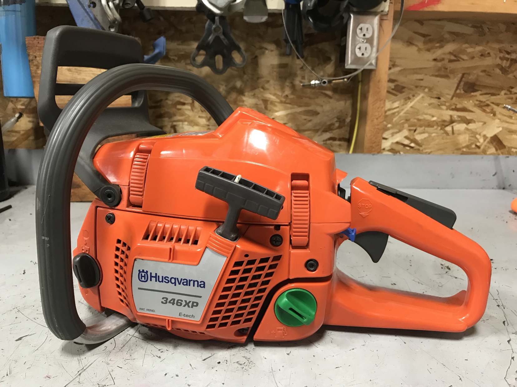

And that is a mighty clean looking example of an OE! Well worth investing a little money and effort into. Makes you wonder why a saw that clean needed a piston job... Bad intake clamp issue?? I don't recall, did the OE have the cursed plastic intake clamp that the 357 and 359 did?

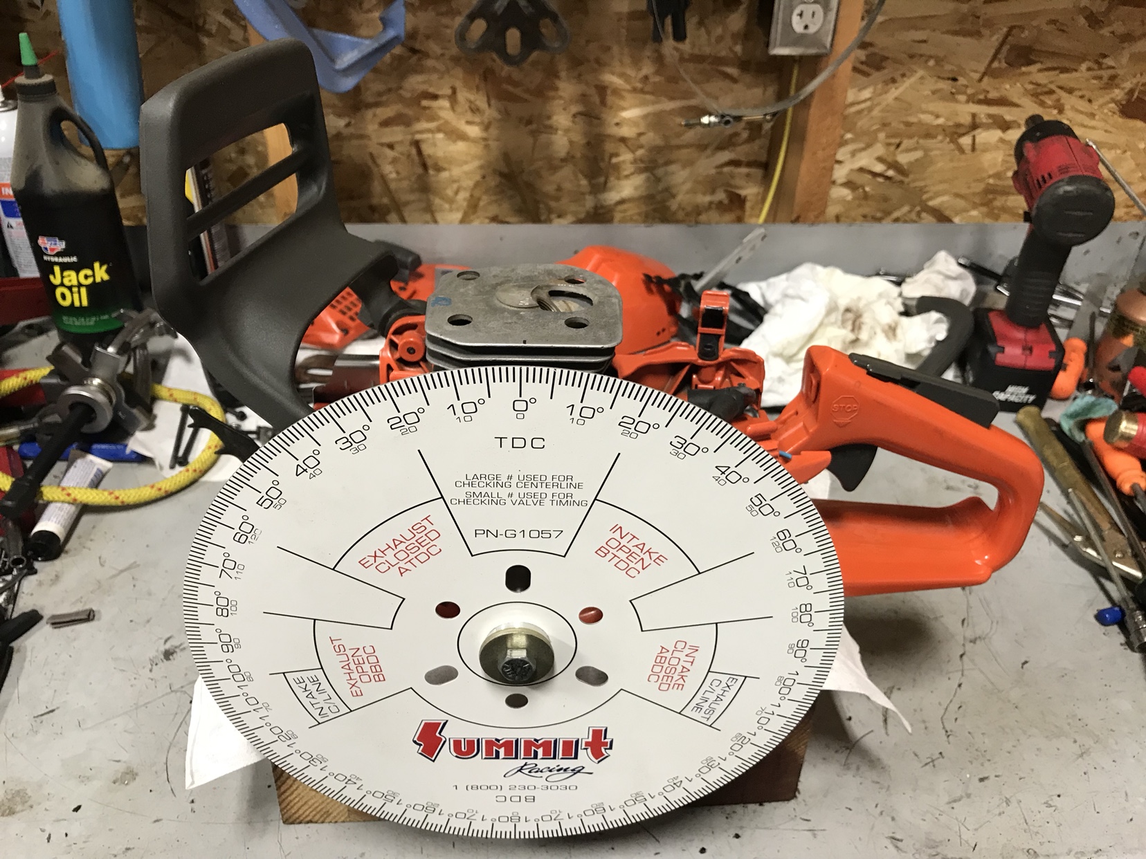

Yeah it’s super clean. Not sure what the failure was. It does have the plastic boot clamp, it’s it’s still soft and pliable. I just got done checking the port timing and took the base gasket out and checked the squish.
