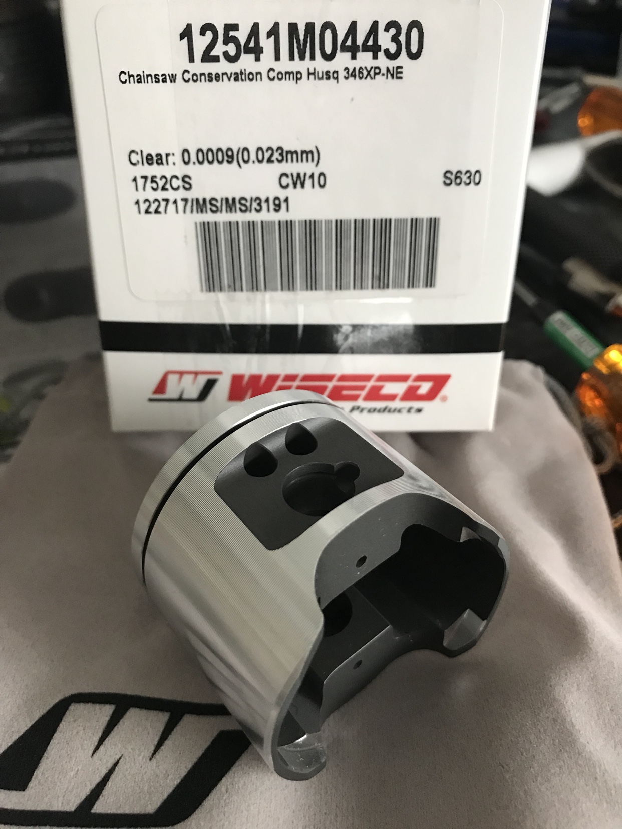

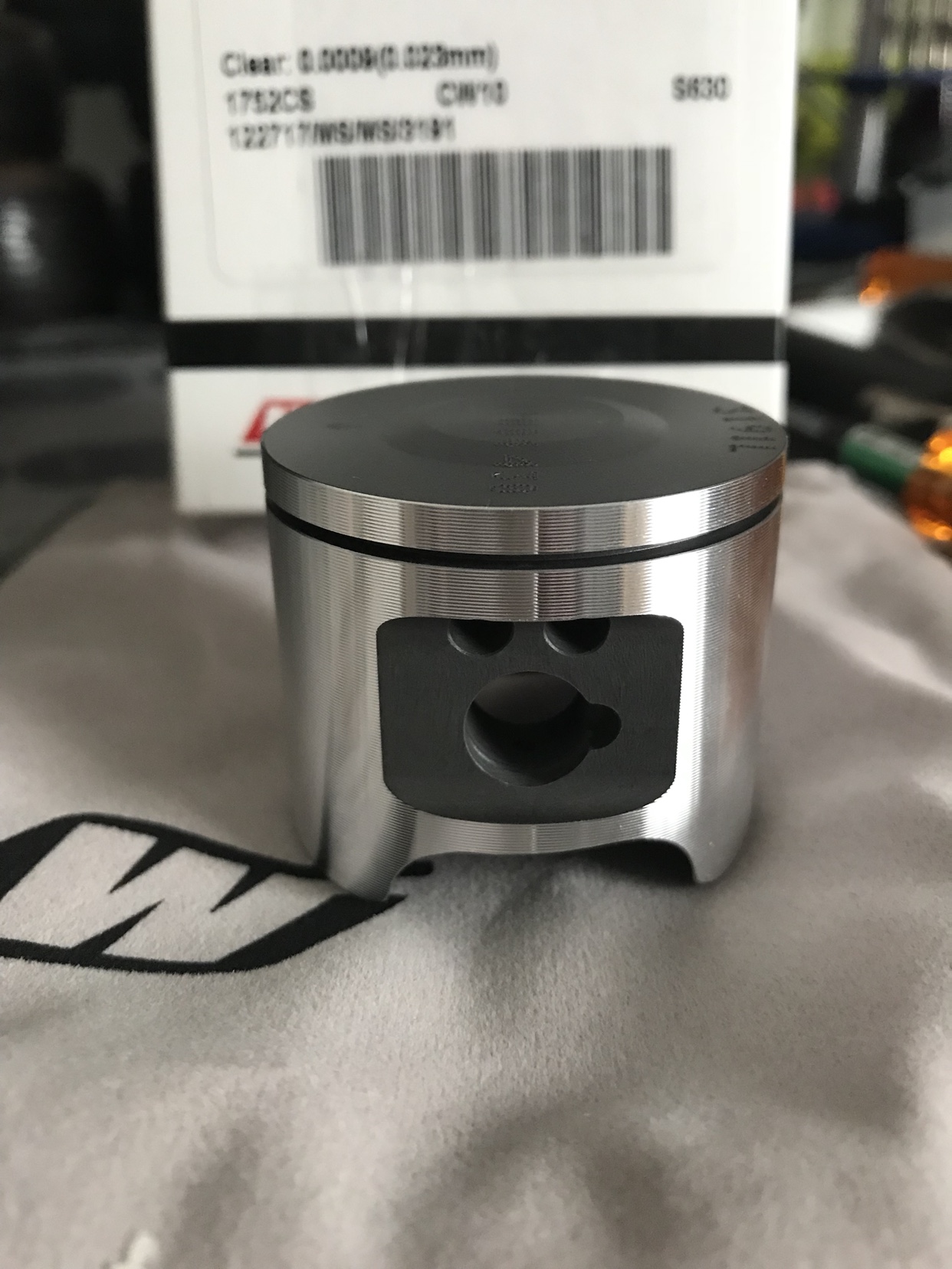

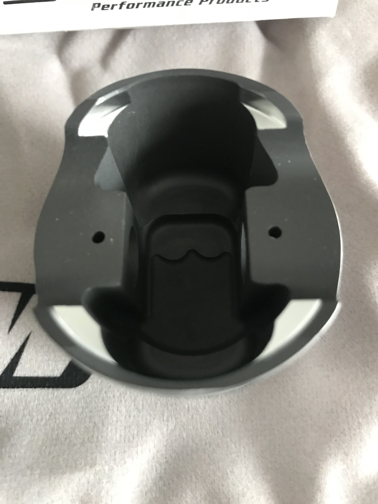

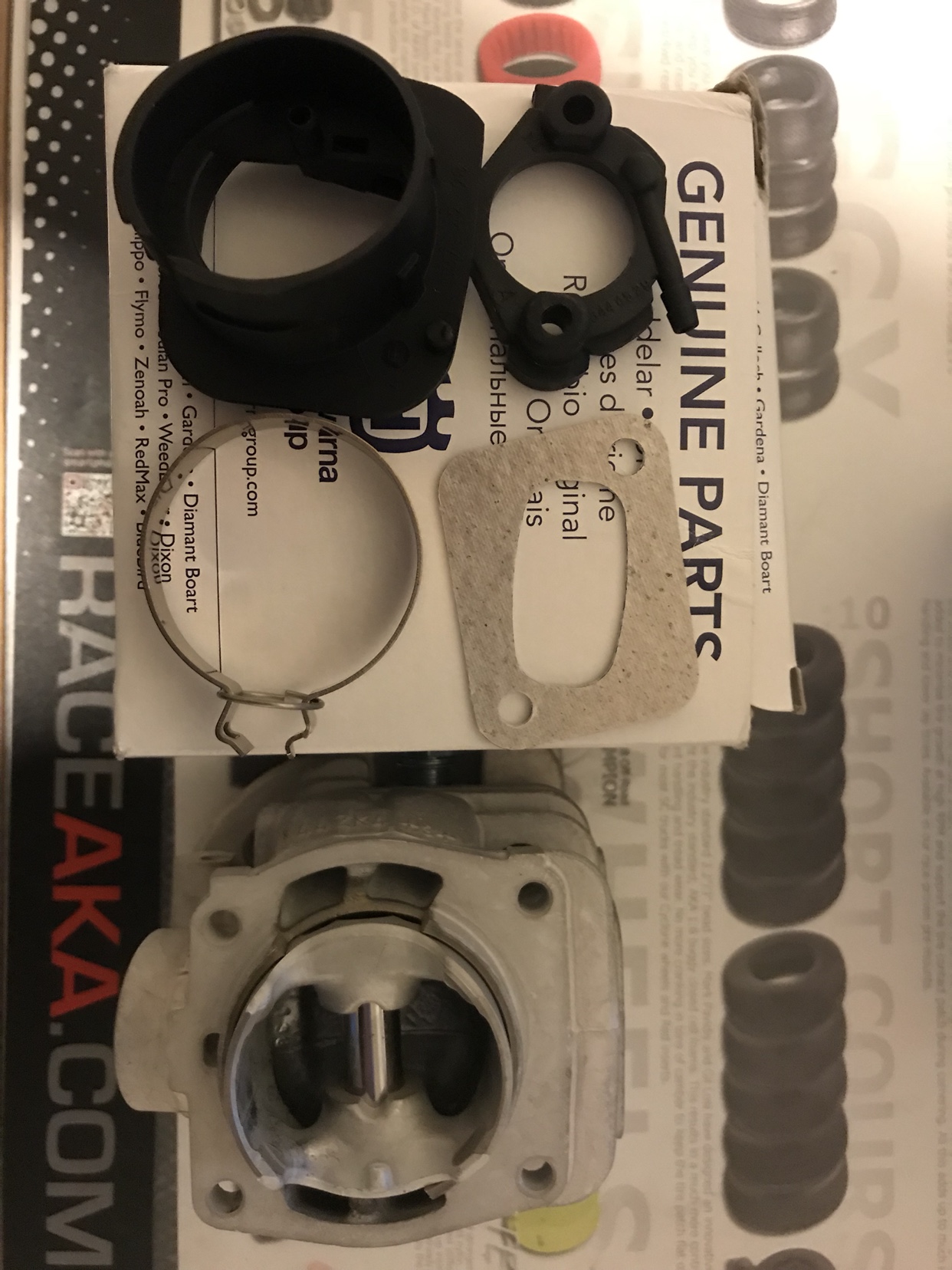

Ok so I ordered the new OEM cylinder and piston and was getting ready to put it together and found this online.
Naturally I figured I should buy it and give it a try. So it just showed today. Gonna see how it works. I have a Dominant/Wiseco pop up in my 372xp that I love. So I hope this one is good too! We will see.
That’s a pretty slick lookin slug. Any chance you could post the weight compared to an OEM piston? Just curious

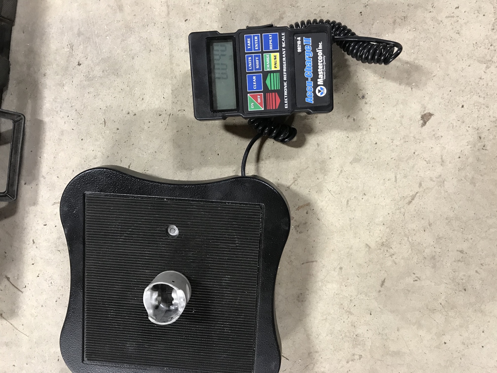

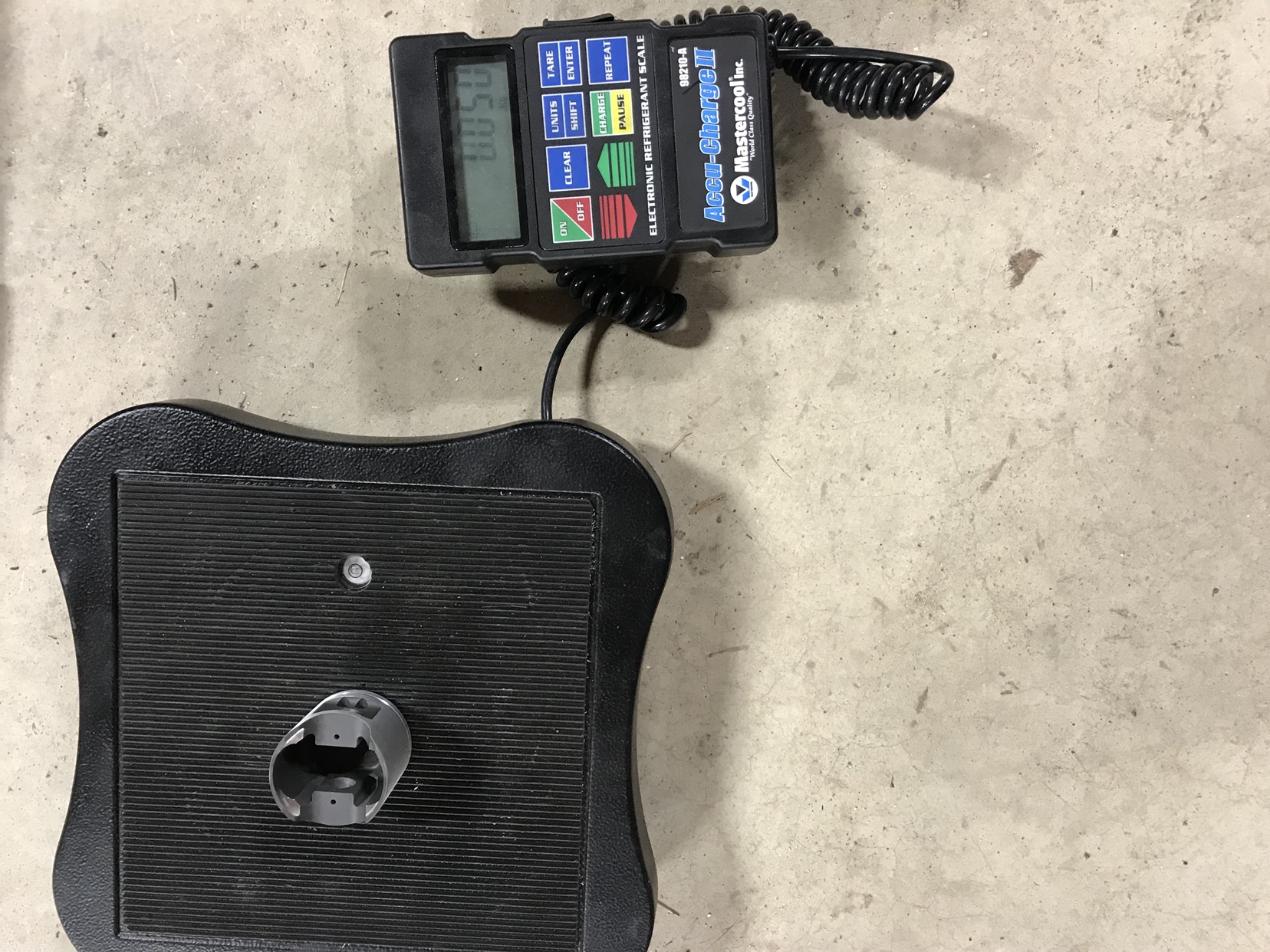

Well my scale isn’t that great but I’ll give you what I have. Looks like there is plenty of material remove to reduce weight. They do feel really similar but that scale shows a little heavier on the new Wiseco slug.
The Wiseco scaled in .1 kg above the stock one. But it was bouncing between same weight and .1 difference. I wish I had a better scale around the house. But I don’t. Just my ac refrigerant one.
Interesting, thanks for posting.

I've come close to ordering a Wiseco piston a couple time, but just haven't yet. Will try one at some point. Would be better if it were lighter than OEM.
Yeah I agree. Wish it was more like the Dominant one I have for my 372xp. That thing is lighter than stock! But I figured I would try. Maybe I’ll grind some weight off of it! [emoji38][emoji38]
Don’t let my query about the weight ruin your excitement for that piston. Sorry if I have you doubting it now. :oops: I don’t think it’s a big deal. If your scale went to a smaller gradient it might only be a couple grams difference. Think about the weight difference between the OE and NE piston, they didn’t change the crank at all to my knowledge and I’m sure there’s a much bigger difference in weight between those 2 pistons.
Oh I am not!!! I ordered this thing to try it out and hadn’t heard or seen anyone with one so I figured it was a gamble. No doubting here!! Lol. It’s not a huge deal on weight but I wish they would have thinned it down a bit just for a reduction in rotating mass. But I think the compression bump from the pop up will add more then the loss of power from the little added weight. Hopefully I can get it running here soon. Was gonna do a port job on it and just be done. But I might do a little at a time and experiment some to know how much increase I get.
