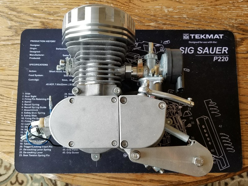

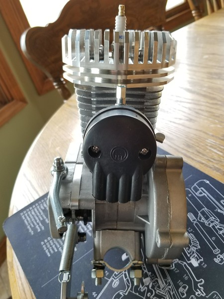

I'm just going to leave this here for inspiration. This kit was pretty fast. 40mph on the flats from a 40cc weed wacker! I never put a pipe on because I kept breaking spokes. They sell a wheel with beefed up spokes to match the kit though.

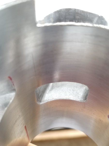

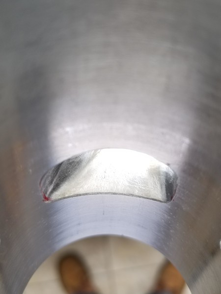

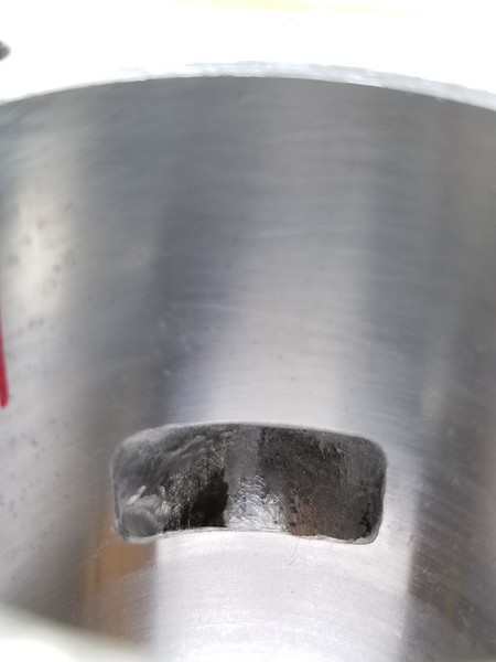

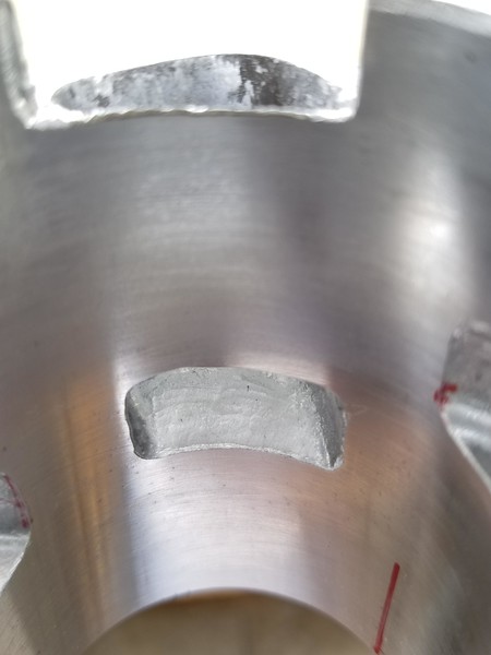

I finally felt up to porting the cylinder this morning. I'm not real fond of the exhaust and transfer port timing, but I'm working with what I was given. After cleaning up and evening up the transfers, they are at 112. The one side was quite a bit higher than the other. I raised the exhaust up to 96 just to get some decent blowdown. It has to run better than it would have with uneven transfers and only 9* of blowdown. I'm not worried about compression. I'm probably borderline with the small combustion chamber I went with anyway. The only thing I could do is to drop the jug maybe .40", but I'm going to see how it does like it is. It will have a pipe on it, so it might like these numbers. We'll see. BTW, the intake ended up at 65 just cleaning up the port.
