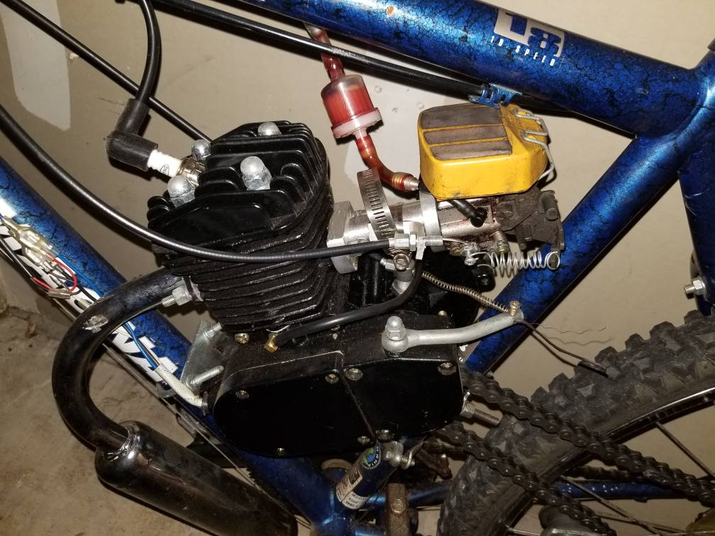

I have one of these...
Made an intake, and adapted an hda carb and 357 elbow/filter
My slide carb was defective out of the box. And who wants to fiddle with jets when ya can turn a screw.
I heard these China kits are all 66cc regardless of how they are labeled. I know mine was listed at 80cc but is indeed 66cc.
Can get close to 30mph with a cheap mountain bike and knobby tires plenty fast enough.

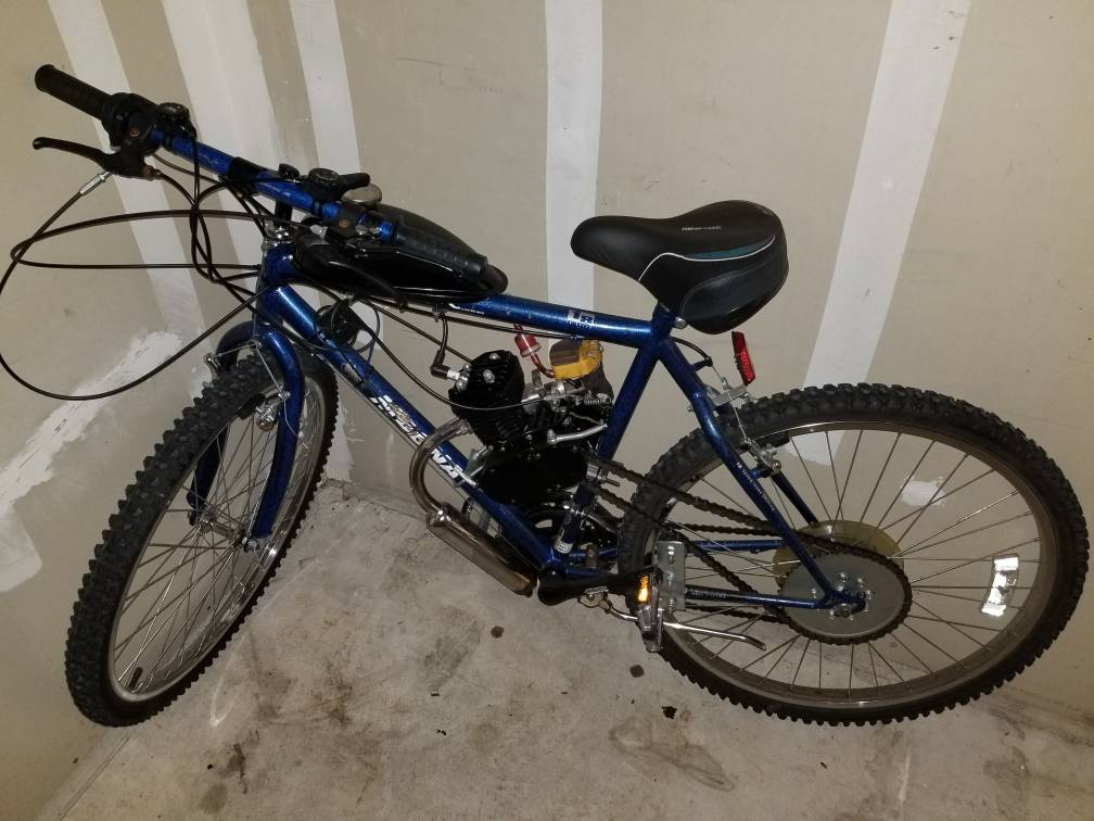

MI
Forgot I still had it up at the work apartment. Lot more efficient that a 1 ton truck for 1/4 mile trips. Guys at the shop love riding it around. Cheap/stupid fun till ya start buying go fast stuff...

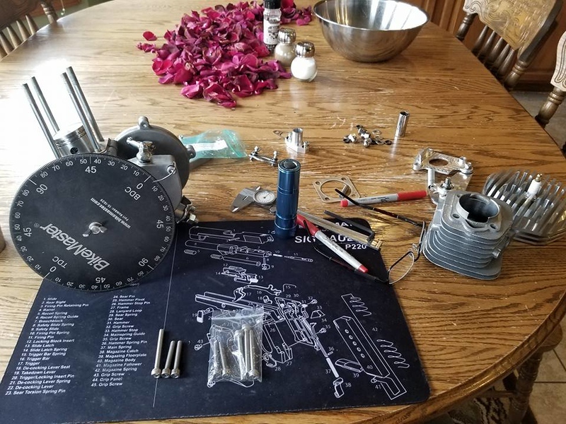

I don't normally work on the kitchen table, but special times call for special measures :)
You are the second person I know Brad that’s allowed to work on an engine on the kitchen table the other person is @chipper1 but he’s not recovering from surgery :D
