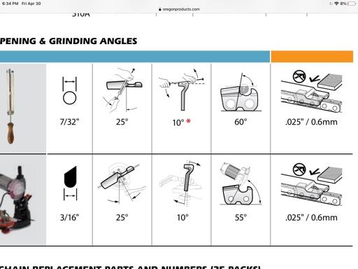

I used to use Oregon 73LG on my 562xp.
My new saw came with X-Cut C85 chain. So far I like it.
I have been sharpening both with my Husky 3/8 roller guide which was designed for H48 chain. 25 top, 10 tilt, 55 hook.
I find it interesting that the recommended angles for the X-Cut chain are different than for H42/H48. Technically it looks like I should be ordering a different roller guide for the C85 chain.
Recommended Oregon angles are close to H42/48
So far I have pleased with the C85 (sharpened my way)

The h48 is very similar to oregon 73lgx. The rakers appear identical in shape. But the cutter is slightly smaller on the husky chain.DA9009A7-2382-44F6-85BE-C68B302172F0.jpeg I find lgx has a longer life, better chip clearance and more durability because of the larger cutter. Not by much. But the difference is there. As far as what one cuts faster out of the box... I have not tested that aspect. Out of the box performance doesn’t really satisfy me with either one. I change all that after I file it anyway and tune the chain to the saw it is on.
