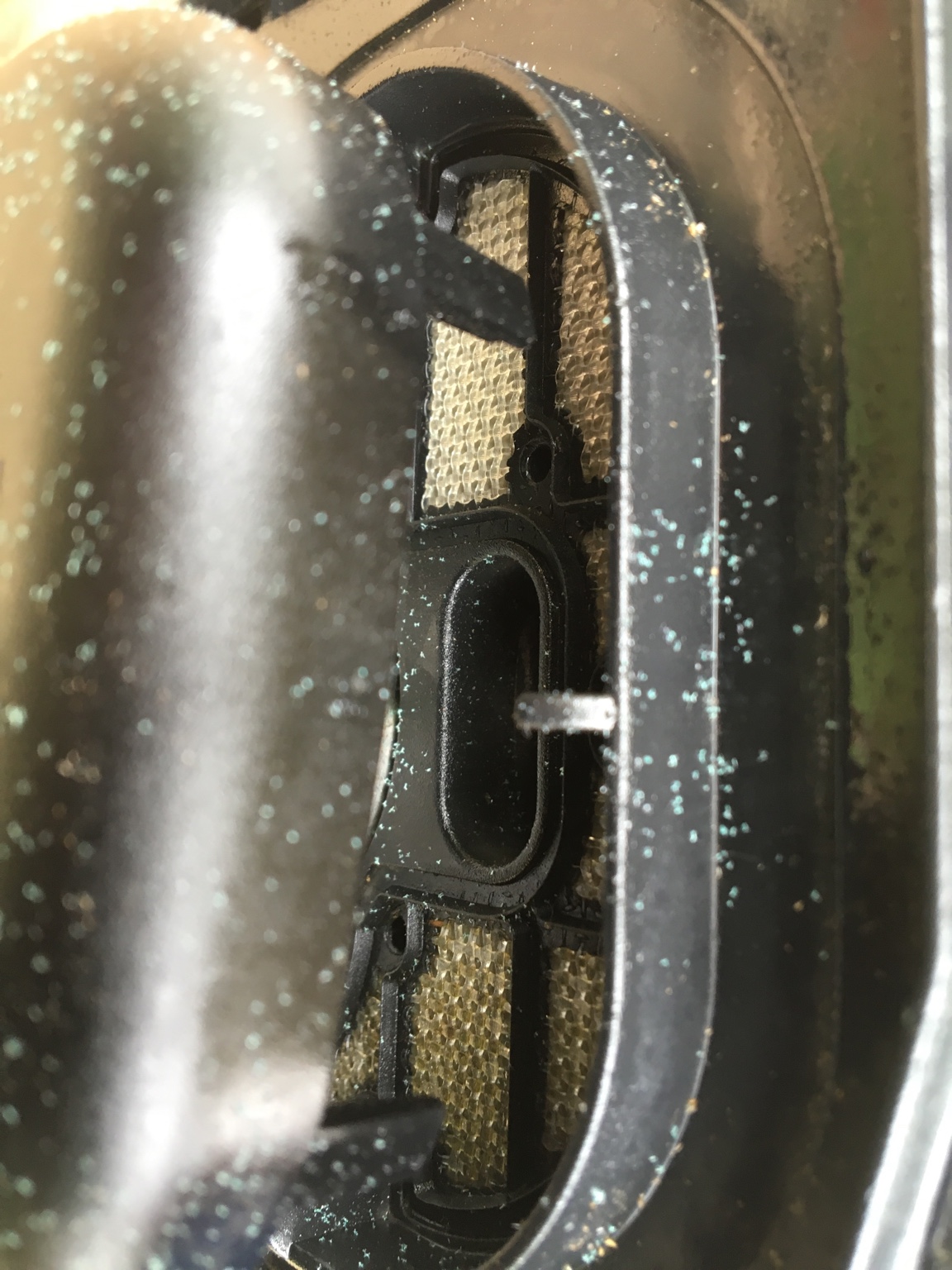

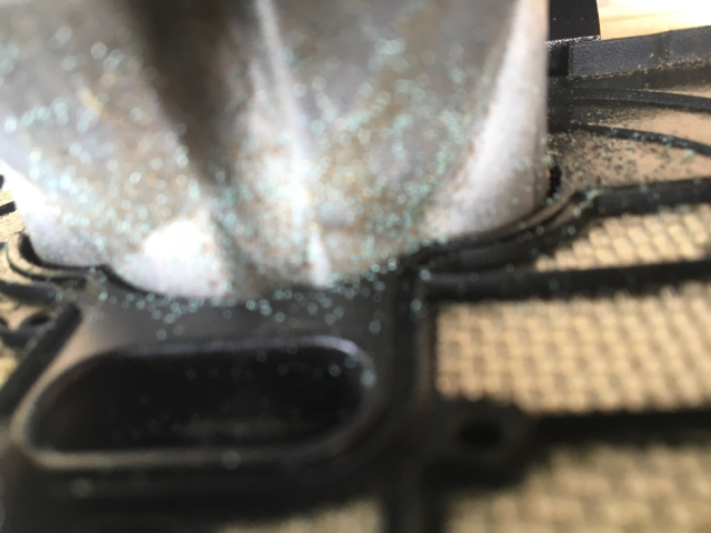

Interestingly when I removed the max flow filter, I found this.
It looks like the filter was coming apart a little. Maybe if I had blown it out first it would have been ok.
New filter. I didn't wash it is why it did that. I didn't think about that doing it. I'll have to wash the other new one here before I use it.
Good data for us saw geeks. It looks like I'll keep running the max flow coverless unless rain. Wonder if more holes would improve it more?
Good to know.
We looked at the setup and it really looked like the cover was compressing and blocking flow.

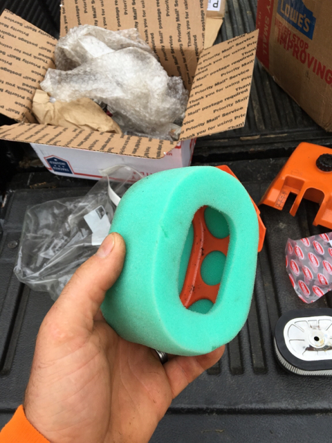

So basically, the big benefit of the max flow is only w/o a filter cover.
Dan, I don't run the spitback cover, and on 2 of my 460s I also removed that black shroud between the cover & saw.
I wonder if that makes it similar to running w/o a filter cover???
Good stuff, thanks for testing. If you ever get a chance, I would like to see the timing tested also. I would also like to see an HD-2 tested. I've got plenty of them (no wrap or foam)!

Eric, Jason cut open a stock filter for a frame for the max flow. The one that comes with it is plastic.
