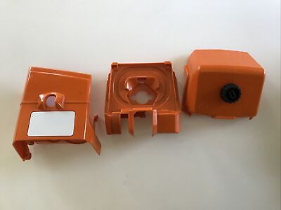

Here’s what I purchase for my early 044. I had a few spare new filters for my 066 so I don’t have a link for those but I know I got them off HLSupply. I also opened up the stock muffler hole and took some of its guts out. It made a world of difference and of course required some retuning.
I didn’t use the top cover, only the filter base and its cover.

These aftermarket covers are ok to use. They dull fast in the sun, but fit well enough.
Fitment was a lot better than expected and for $23 I have no complaints. I don’t think I had to do anything other than put them on to get them to fit. I don’t remember much, or any, cussing 🤷‍♂️
