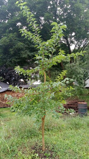

Here's a picture of a 3yr old Osage Orange I planted, it's 2.5" across the stump at 6" above soil now and about 7' tall (it had shot up to about 15' this year but got so top-heavy that the roots pulled out of the soil so I trimmed the large branch off) I'd very much like to see a full-grown one in person, Central PA

Cornelian Cherry is very slow growing and tends to be more of a bush type plant, although apparently it can grow into a tree.
Its cherry like fruits are edible and considered a delicacy for making marmalade, cakes & pies.
