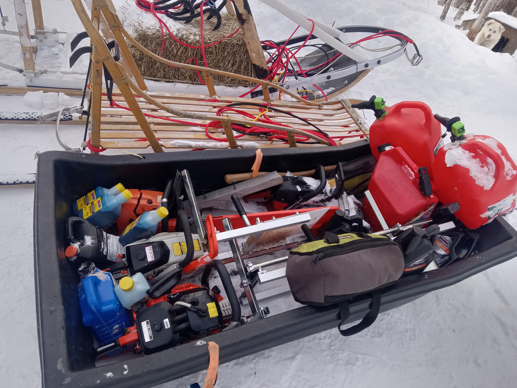

mainer_in_ak
2:03 AM
22880
Mar 13, 2022
348
1,364
Interior Alaska
I'm running amsoil saber at 32:1 ratio. It's easy to find here in Alaska and is reasonably priced per quart, cheaper than hp ultra or red armor.
Mostly milling with a ported echo cs 1201 and a ported cs 6700, always 16 ft long rip cuts. Could use all the oil I can get, the saws get warm on such a long rip cut, so 32:1 in everything.
It burns clean at 32:1. Years ago, saber didn't have a fuel stabilizer, but it does now.
