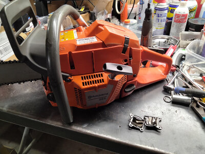

Today I installed my last two parts for a Husky 365 that I bought from @redneckhillbilly (great guy to buy from!!). This was a fun project saw, it needed a new flywheel side case half (rear mount was busted off), new AM fuel tank, starter pully, and pull handle. Since I was splitting the case, it got new gaskets, bearings and oil seals. I also swapped out the 365 transfer covers (sitting next to the saw) and installed 372 transfer covers to beef up the saw. The saw fired up on the 5th pull (ran before, just not safely) and smoked a bit and needed only minor carb adjustments. I am quite happy with this saw, wasn't looking for a 3 series saw, but could not pass up this deal!
