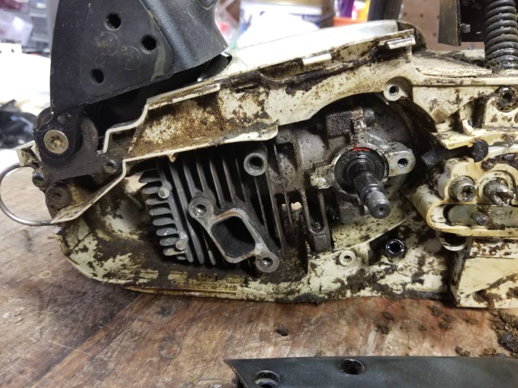

Got a 192t freebie from my dealer. Came in with a scored piston. New OEM piston was $19.99! Doing a pressure and vac test now before I remove the cylinder. Hoping to have it back together by morning so i dont forget what goes where! Lol!
