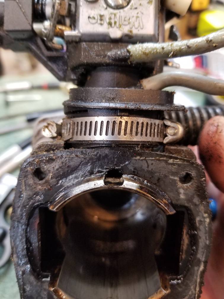

2159 needs a rebuild p/c are pretty clean and should clean up nice. Very little scoring, ring was still free. Probably clean both up and just put a new ring in. Bearings feel ok ,but we'll see about them later. First redhead ,should fit in nicely with the 346 365 371 and 372.
