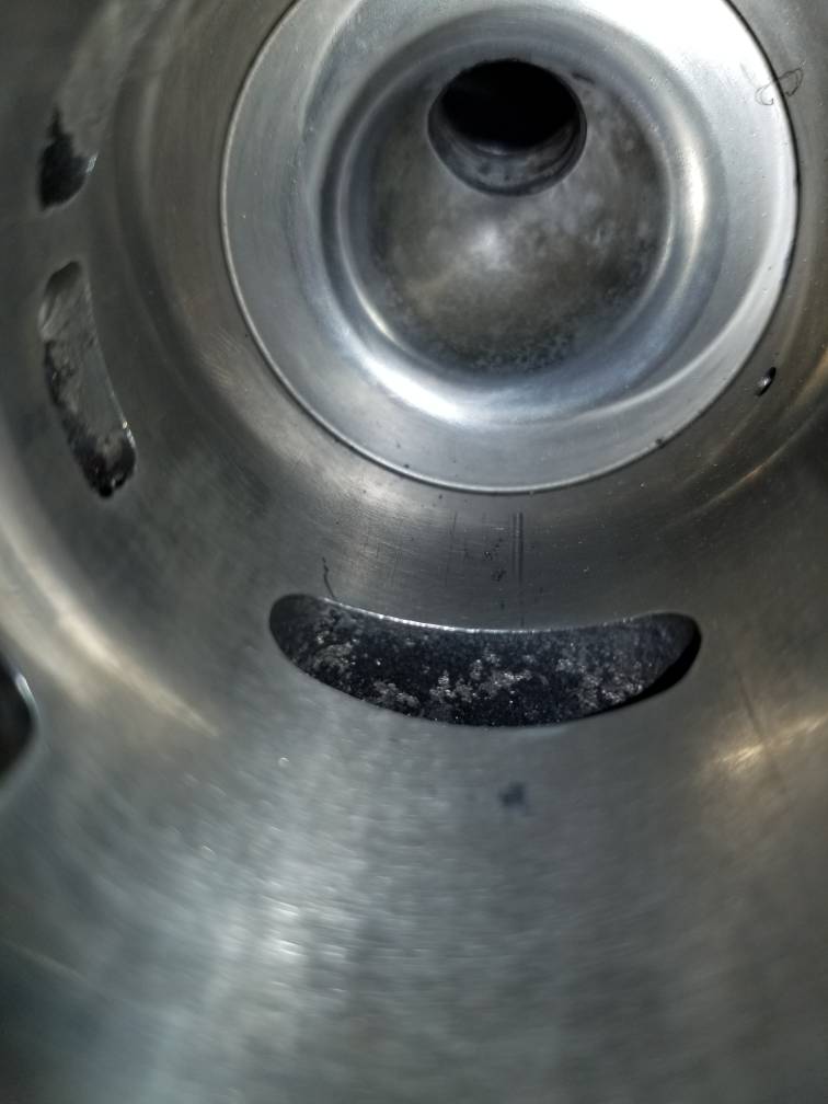

Thoughts on running this cylinder on my 2159. Cleaned transfer off and this is the damage underneath.
Looks kinda like mine did. Did ur cylinder have pits or holes in the plating after cleaning?
