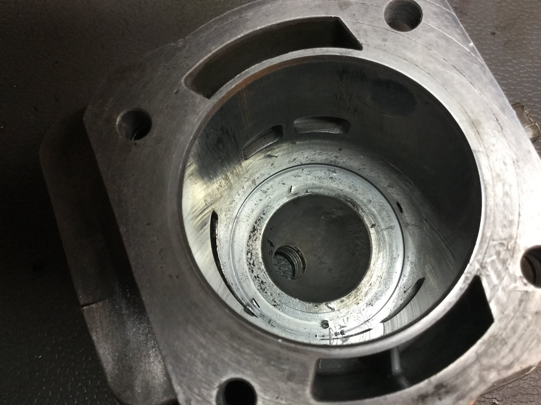

See those little dark spots and slashes on the squish band?
They’re little gouges that have accompanying gouges on the piston..
I wouldn't worry about that in the squish band but I'd want to know what made that damage. As Mike was saying pull the seals then check your bearings. I've seen a few that feel good till you pop the seals out.
This. I have unfortunately trusted the “feels good” test method and had to go back and tear the entire saw back down and replace the bearings. Lessons learned! Now anytime I do anything more than a basic tune-up I plan on and quote replacing bearings and seals. Better safe than sorry, especially if you have to eat a $200 top end
