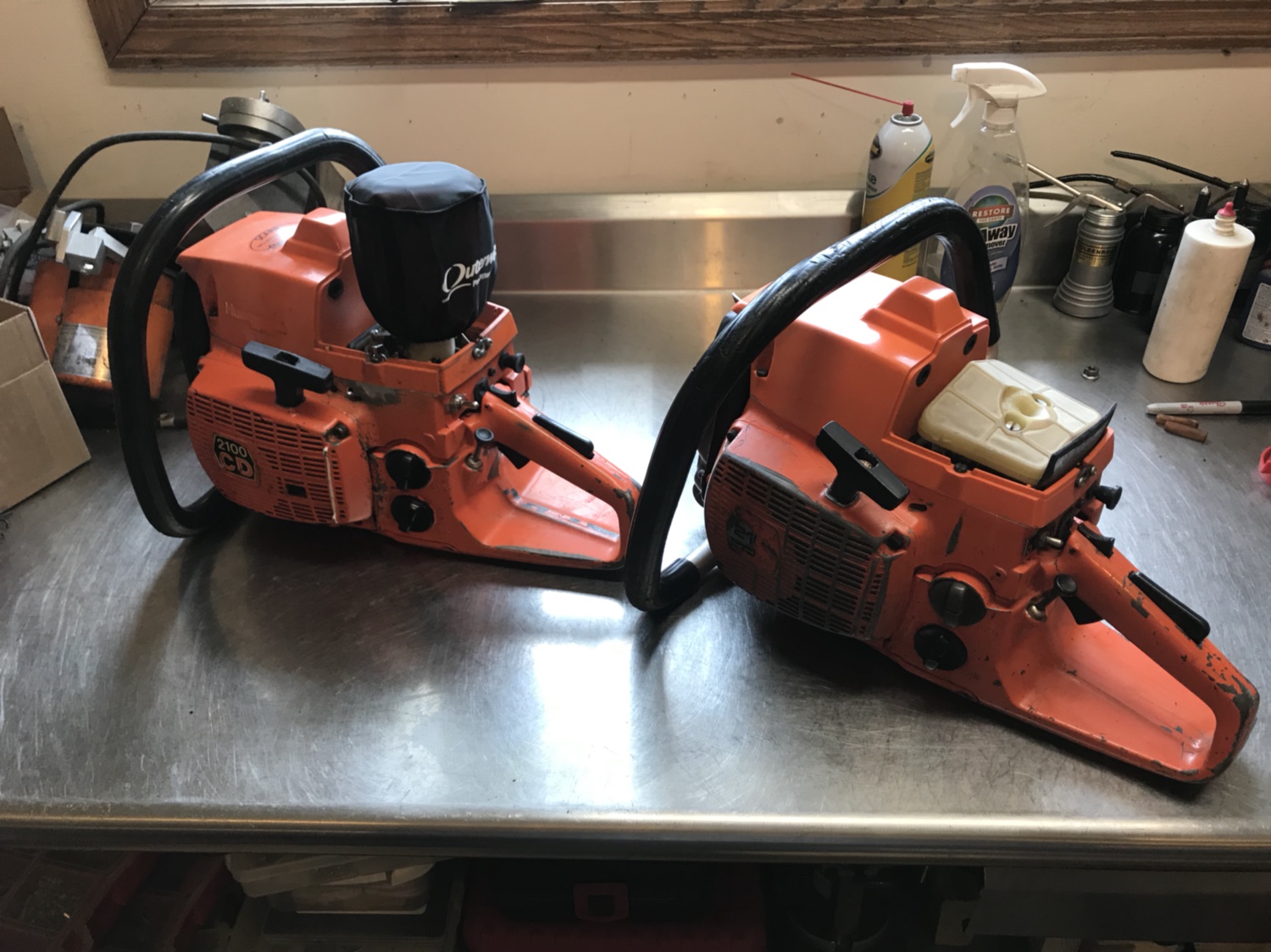

This is one I put together for @Mo Jim. Ported with a 395 piston, but it has a stock muffler outlet with spark screen, and stock carb. A little different from my normal build but it turned out very nice. FYI, I think it will be for sale soon.
Then there is this one I put together for Rod.
