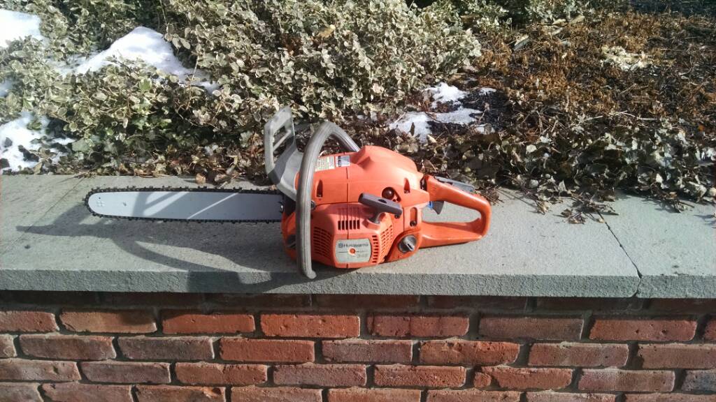

Was on the bench this morning...345 that my son repaired. Runs pretty good!
