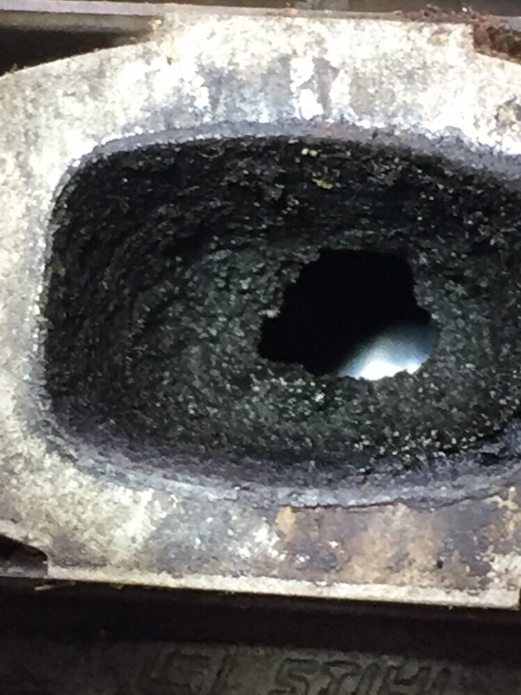

Ten USD to a donut they been using outboard motor oil.
