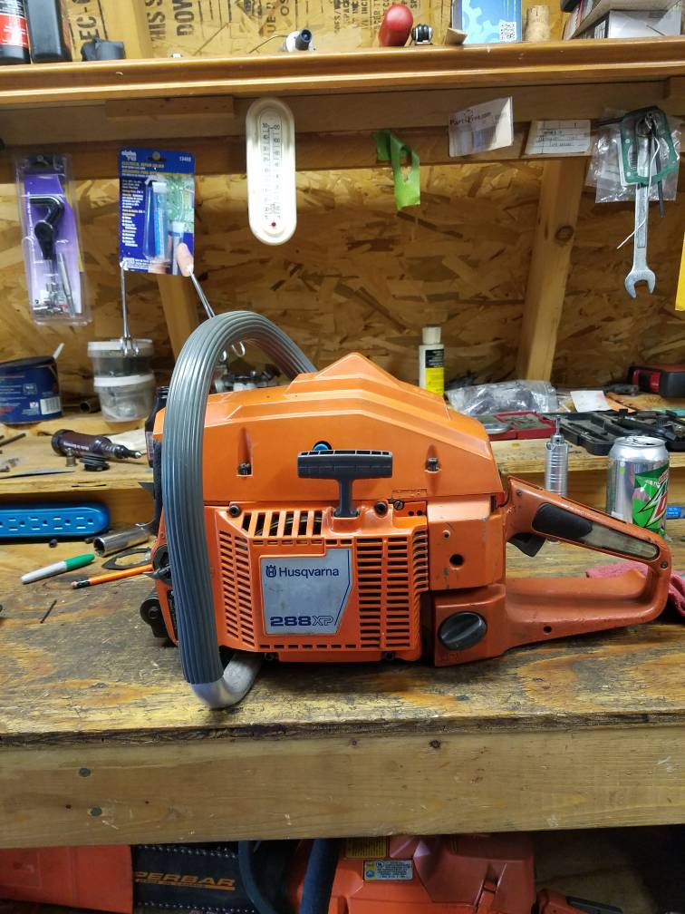

Put this on the bench this morning got it tore down pulled the gasket to check the squish when I sit the cylinder back on found this no piston look like this

New piston?

It's got some run time on it not sure how much

To me it looks like about 90 seconds but with my extreme lack of knowledge and failing eyes,would be hard to say. So what am I missing? Customer's saw or yours? Do you see any advantage in a high top vs the low set up? I used to want high tops for mine but that sleek sporty look is quickly becoming my favorite, visually any way....

Not my saw look at the 1st picture cylinder isn't sitting on the case without the piston 2 pix no piston in it sits down flat tryed 2 different piston

What's up with that?
