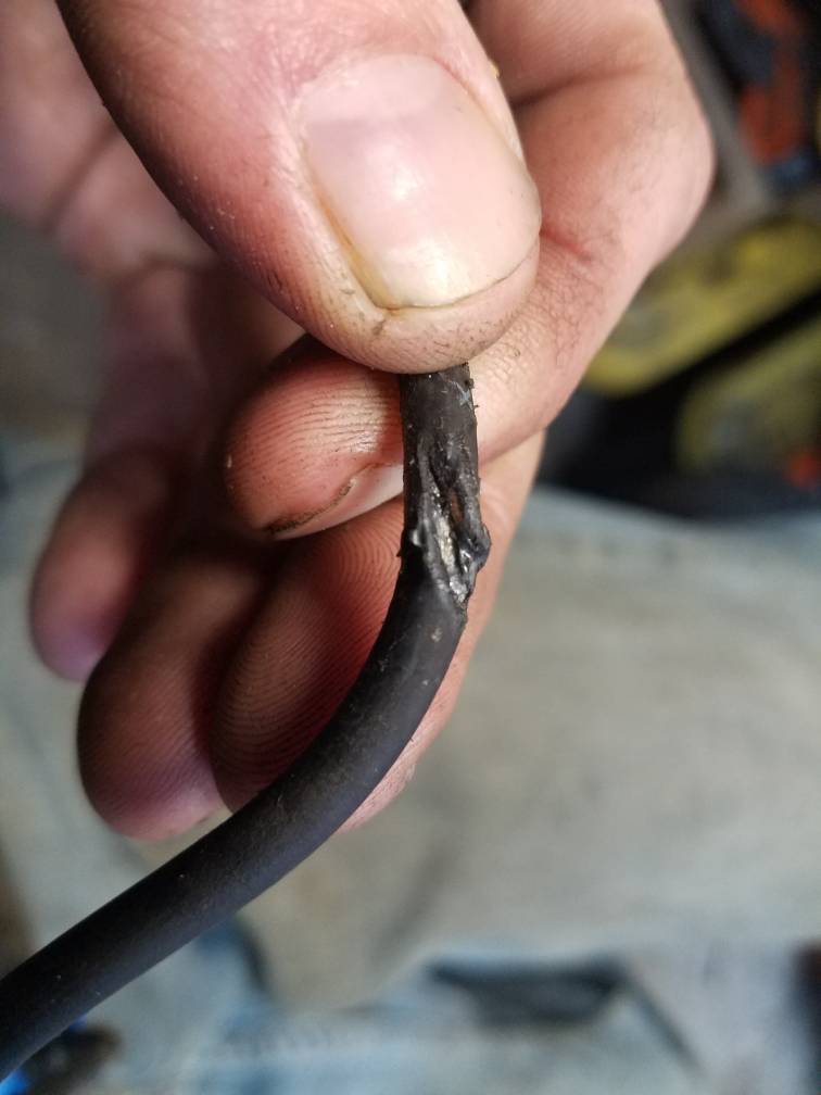

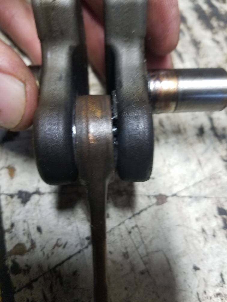

372xt on the bench for a logger friend. He said it wouldn't pull over anymore. Found a bad con rod bearing and bottom end was as dry as a popcorn fart. He runs 50/1 stihl orange bottle. So I tore it down and put new crank, bearings, seals , and a mild port job. Numbers are 98.5, 116, 78.5. Everything went together smoothly and it fired up on a couple pulls. This morning I went and cut a load of wood with it and all was well. So I tell him to come get it. Whenever he gets here it wouldn't fire for anything. [emoji15] no spark. The coil wire got pinched in between the cover and cylinder and was grounding it out. Replaced it with a new piece of wire and some heat shrink for added insurance. Purrs like a kitten now[emoji2] [emoji2] . Couple pics, forgot to take some of the cylinder before I glued it on...

Tell him thoose Hooskies dnt like stihl mix, husqvarna grey bottle 40:1, it runs well in anything, even Stihl saws appreciate it.;)
How's it going Dustin?? That's exactly what I told him pretty much. Awhile back he brought me a bunch of saws, everyone had bad con rod bearings. I told him back then he needs to switch oil and go to 40/1. I hope he listens this time. He's supposed to check with his local dealer and see what other oil he has.

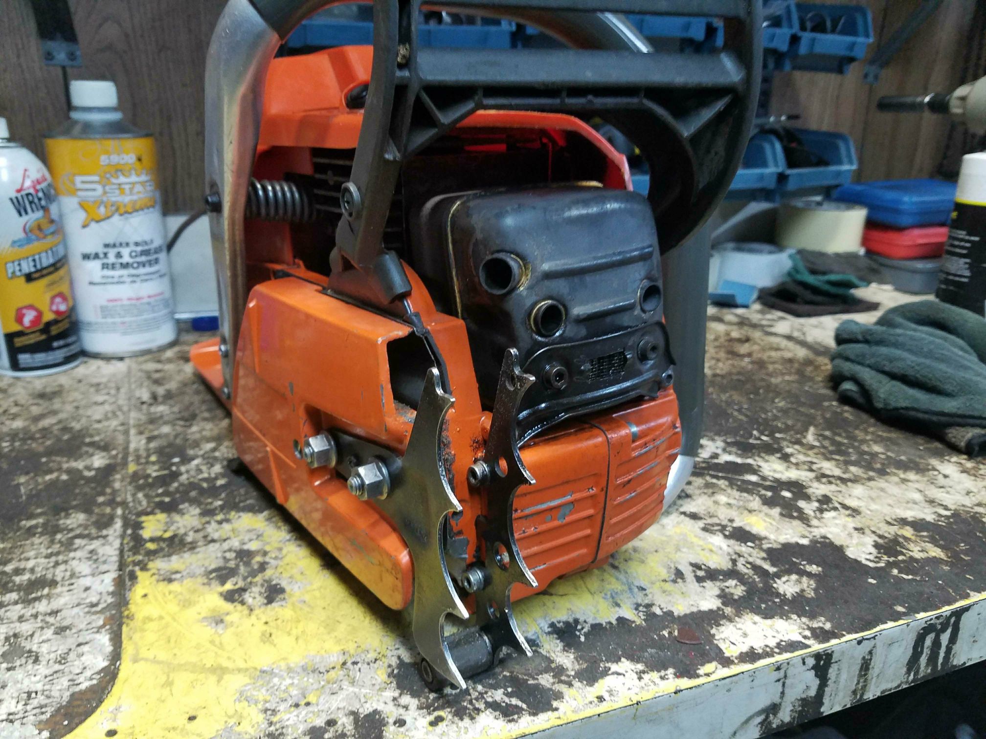

Another old project that I put away for a few years, I got so far that it start up and runs smooth :D Miss the same parts as all my 362/372's do, the guy I bought a huge batch from strip of the brake flags before he use them, toss them in the bin.
Picked this dirty saw up in the post today. Cleaning, new ring, seals, and the normal stuff they need. It's a keeper!
