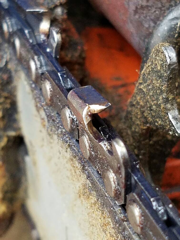

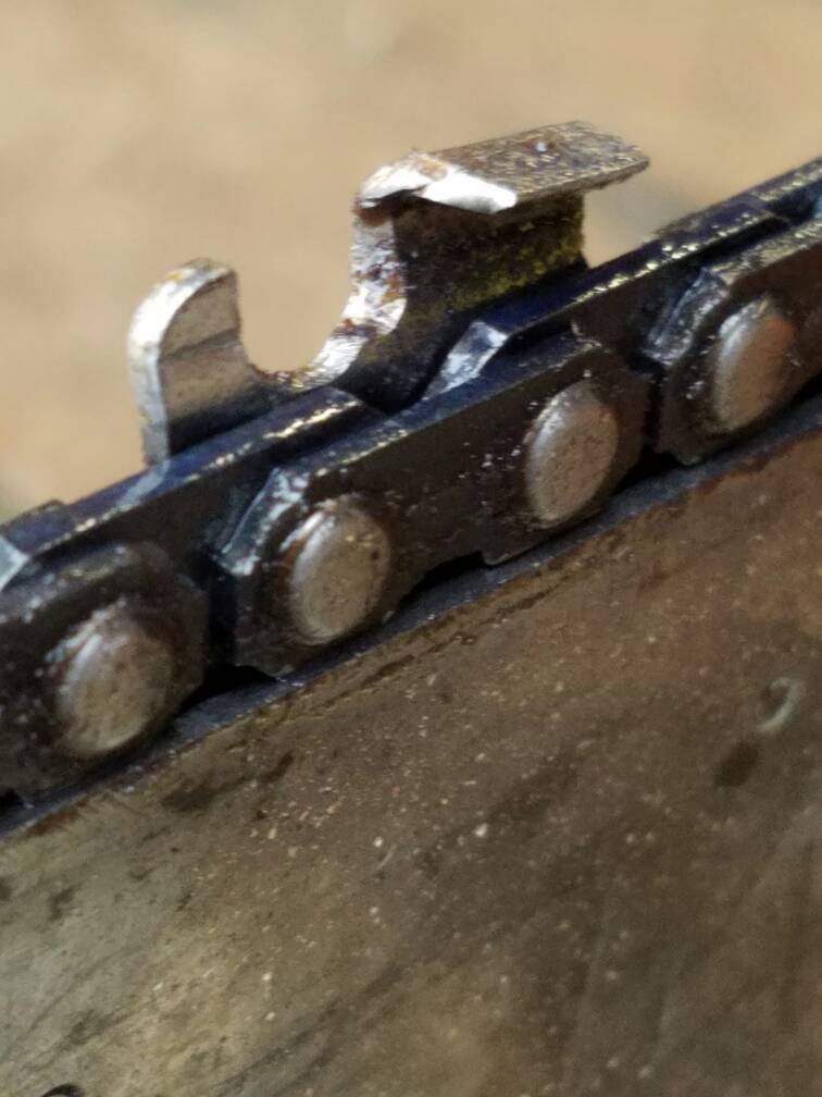

peter92
3:38 AM
1308
May 19, 2016
847
1,555
maryborough qld aust
picked these up today to go on the bench and enough new full chisel chain to make a 98 DL for my 30'' bar
