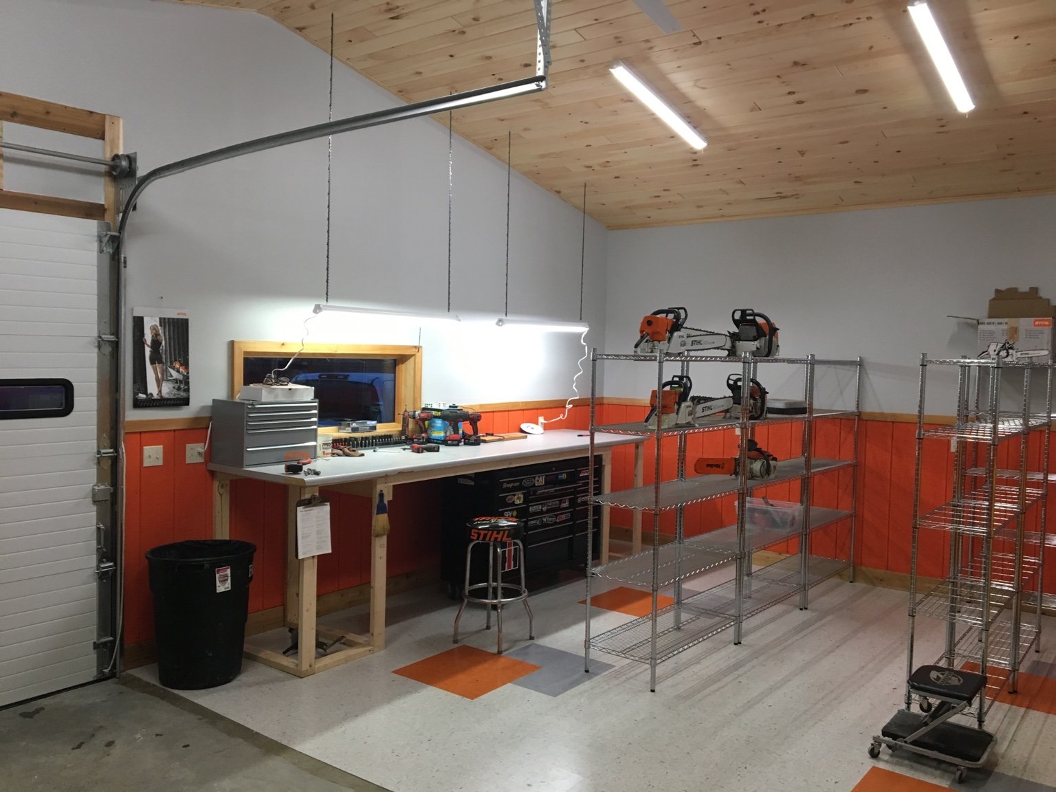

9:18 AM
309
7,958
50,491
Ontario, Canada
That's awesome @Cobby08. :thumbsup:
I've got shop envy right now. :worship2:
Only thing I'm wondering right now is where is your lathe, mandrels and fordom going;)
I've got some plans for my shop this summer. It's not going to be as nice as yours but compared what it looks like right now anything will be better:D

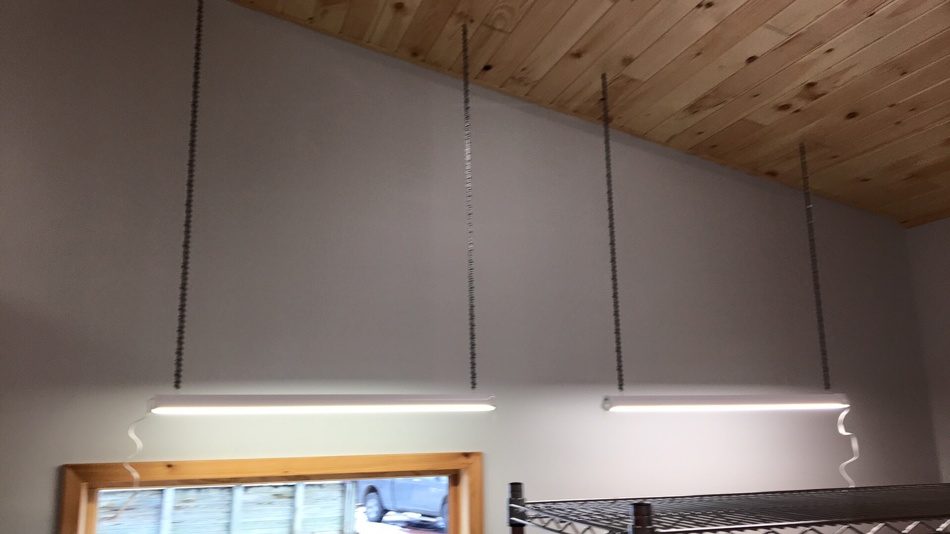

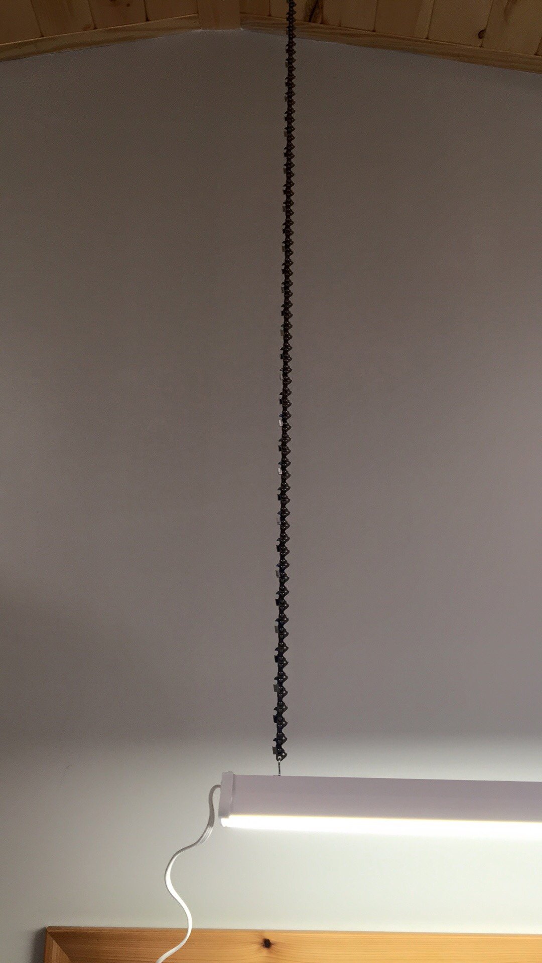

Such a nice shop! I plan to copy the idea hanging stuff from saw chain. Btw nice IH sticker!
Thanks! Go for it I was making a chain and it hit me. I think it's the sticker they reproduce for the 66 series.
Definitive Dave
Piss Rev Mafia Member
9:18 AM
297
5,220
34,386
Central Ohio
a thousand likes
I use the led shop lights too but love hanging them from chain :)
I also use those wire rack shelves, super handy and fit the bulk parts bin boxes perfectly.
We installed the wheel kits on the shelves and it makes reconfiguring the shop super easy when needed.
I really need to rebuild my shop, so envious of that setup right now
