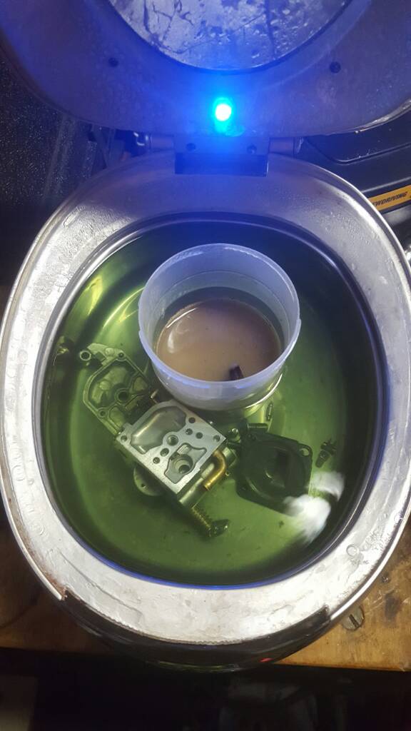

Got a carb from a MS180 in the little USC. A buddy at work said my little saw is bogging. New fuel line and filter and a kit should solve that!
