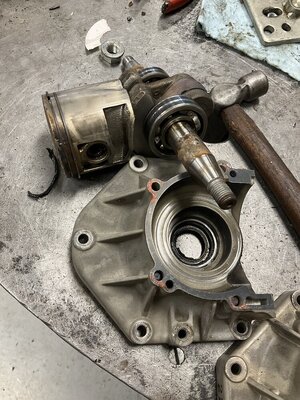

Echo 9010 blower crankcase. The fan side bearing is a good Japanese NTN but this is the second one I’ve seen with a failed cage. Both times the units were run without oil and it seems this is the first thing to fail, even before enough scoring takes place to lower the compression.

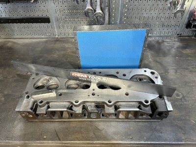

Will the head gasket make up the difference?
The spec is .001” per cylinder so a v8 head needs to be warped less than .004”. In other words it was within spec before I started but not great. now it’s less than .0015 so that’s quite good.

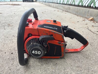

The 450 is starting to look a lot nicer. I have been repeatedly washing and scrubbing it to get the caked on crap off. It’s probably the most deeply dirty saw that I’ve ever dealt with.

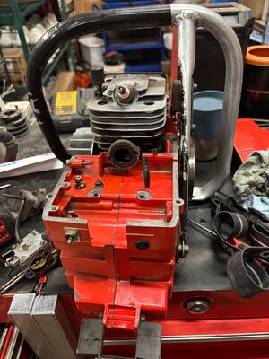

The other Jonsereds 910e is also cleaning up nicely. Replaced a rear AV bushing and rear handle assembly. This is going to get new fuel tank vent, impulse line, fuel line and filter, and carb kit.
