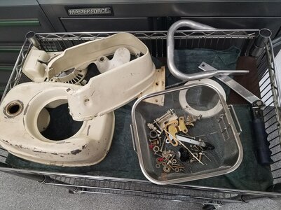

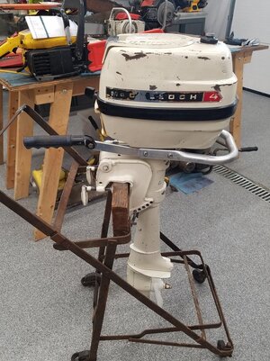

Needs a good cleaning and inspection. We will have to make a few gaskets on the way back together since some were torn during disassembly. I would like to hear it run but I don't think I will go out and buy a boat...the fuel tank is rather rusty inside so this may be another "runs on prime" sort of display piece.
2.125" bore x 1.5" stroke makes this one 87cc, I think the block started life as one of the Super Series engine designs but has some modifications for this outboard application. It uses the same thin piston rings as many of the saws (48691).

heimannm
8:38 AM
714
Jan 28, 2016
4,228
30,545
Dike, Iowa

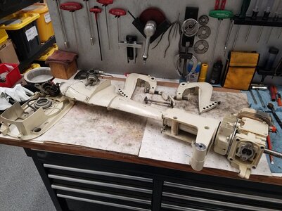

All cleaned up and going back together...we had to make a couple of gaskets for the pieces that connect the engine to the shaft housing and that slowed things down. I have a bit more cleaning to do on some of the exterior pieces to try and remove some stains but I do believe it will look pretty good in the display, assuming I can find a space for it.

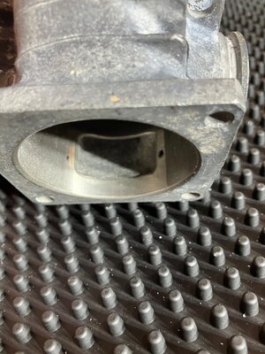

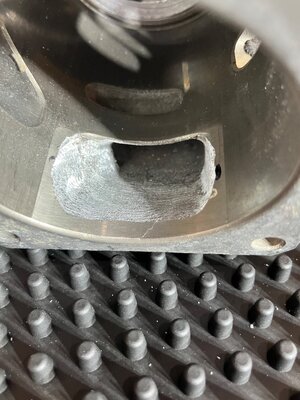

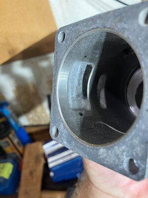

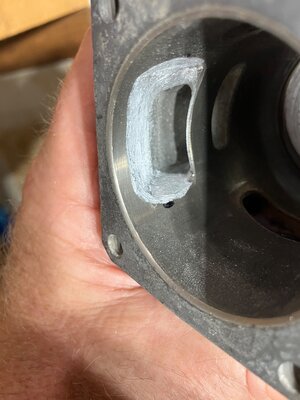

Too much? Not enough? Just right?
044 jug whittling

heimannm
8:38 AM
714
Jan 28, 2016
4,228
30,545
Dike, Iowa
All together again. I did give it a prime and it fired right up, but with the condition of the fuel tank I don't think I will bother fueling it and running it in a bucket of water...even though it is an air cooled engine, there is a water pump of sorts in the lower end that pumps water up and splashes it on the bottom side of the crankcase and mixes water with the exhaust gasses as they pass down the shaft housing and discharge underwater.

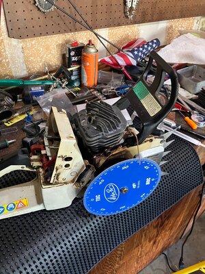

After failing lesson 1 of @Mastermind school of saw dentistry with unneccesary lower transfer whittling , feel like I'm hitting all the OPE consenus magic numbers way too easily on this 044.
Squish band cut 30ish Base ? Eased it down till I got 20-25 squish
Intake 78 exhaust 102., Stock. 71 and 99 . Cut intake. Exhaust 102 came with base cut and gasket delete.
Transfers 126 after base cut and gasket delte, 123 before. little cut off wheels in the mail
Shooting for 122
Something has to be wrong because I ain’t living right. Did start the day off breaking a ring......... again.
Outback
6:38 AM
2046
Oct 28, 2016
315
1,000
Oregon
What a smelly saw. The start/stop lever is the wrong color and your fins are on sideways. You must be on the weak crank. At least your wheel is the right color.
Seriously though it looks nice. I like to stick mine on the fly wheel side and snug'em down, I make these little adapters. The old way is pictured but I'm always paranoid it will slip.
Sloughfoot
6:38 AM
26879
Jun 7, 2023
1,901
5,525
Norcal
She's bad to skip baths. Why do you go to the flywheel side with the best color degree wheel?
Outback
6:38 AM
2046
Oct 28, 2016
315
1,000
Oregon
My adapter threads on to the crank, I have two flats I ground on it so I can tighten it down with a wrench. It can't slip like the drill chuck. That way I know it hasn't wandered out of position when I'm checking timing. I realized at some point that I only needed two for most modern husqy's, so not much of an effort and a fun little lathe project. Its been forever but I want to say they are 8 and 10mm internal threads. One less thing I can screw up.

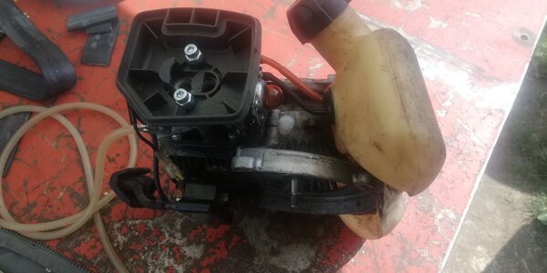

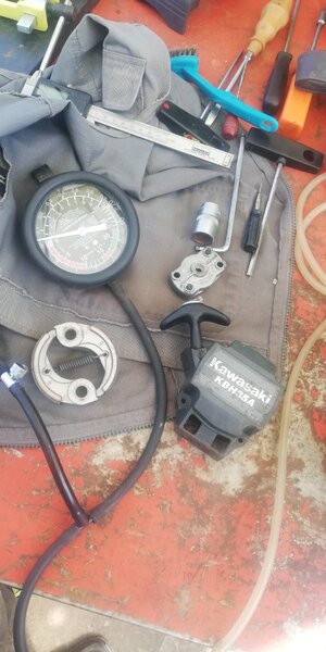

I decided to check where this engine from the brush cutter was leaking, the sealing compound had leaked on the crankcase 🤷‍♂️
