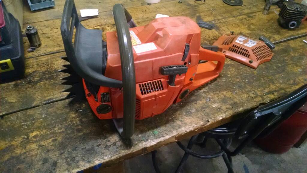

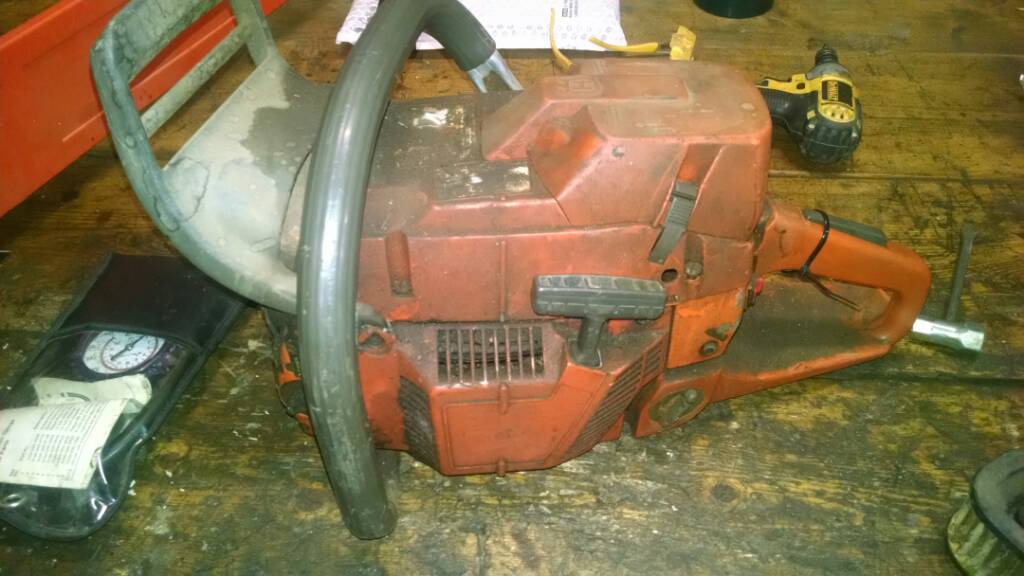

Got the 371 together last night about 11:30 didn't want to wake up the neighborhood so I left it til this morning. It's alive!! Has gobs of compression for just a base gasket delete and it sounds pretty nasty. Now needs a tune, B/C and some time in wood.
Before:
After:
Not quite PSP material but I like it!

That's a nice saw to me. I don't mind the rough plastics. Glad the cylinder worked out good.
