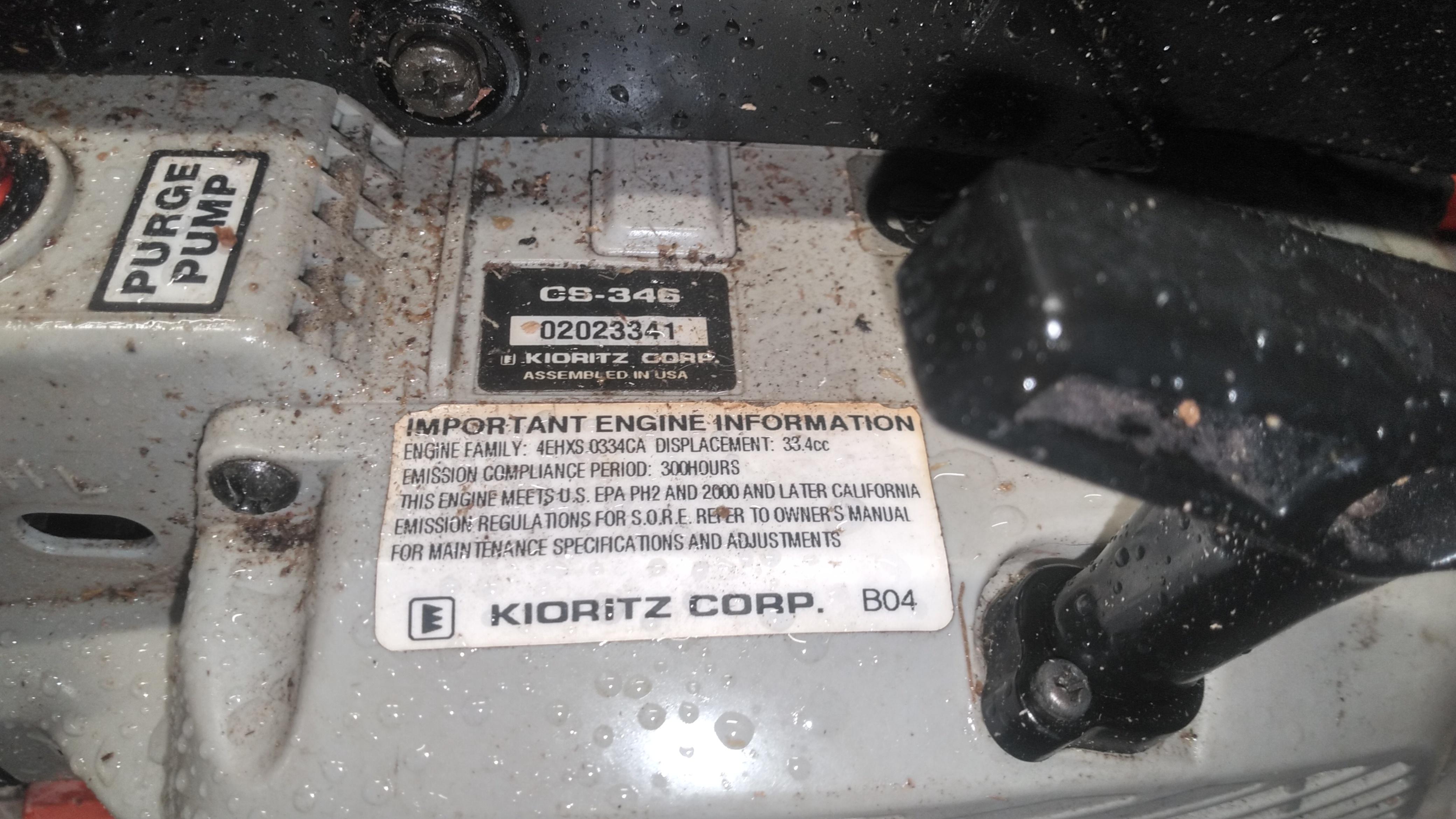

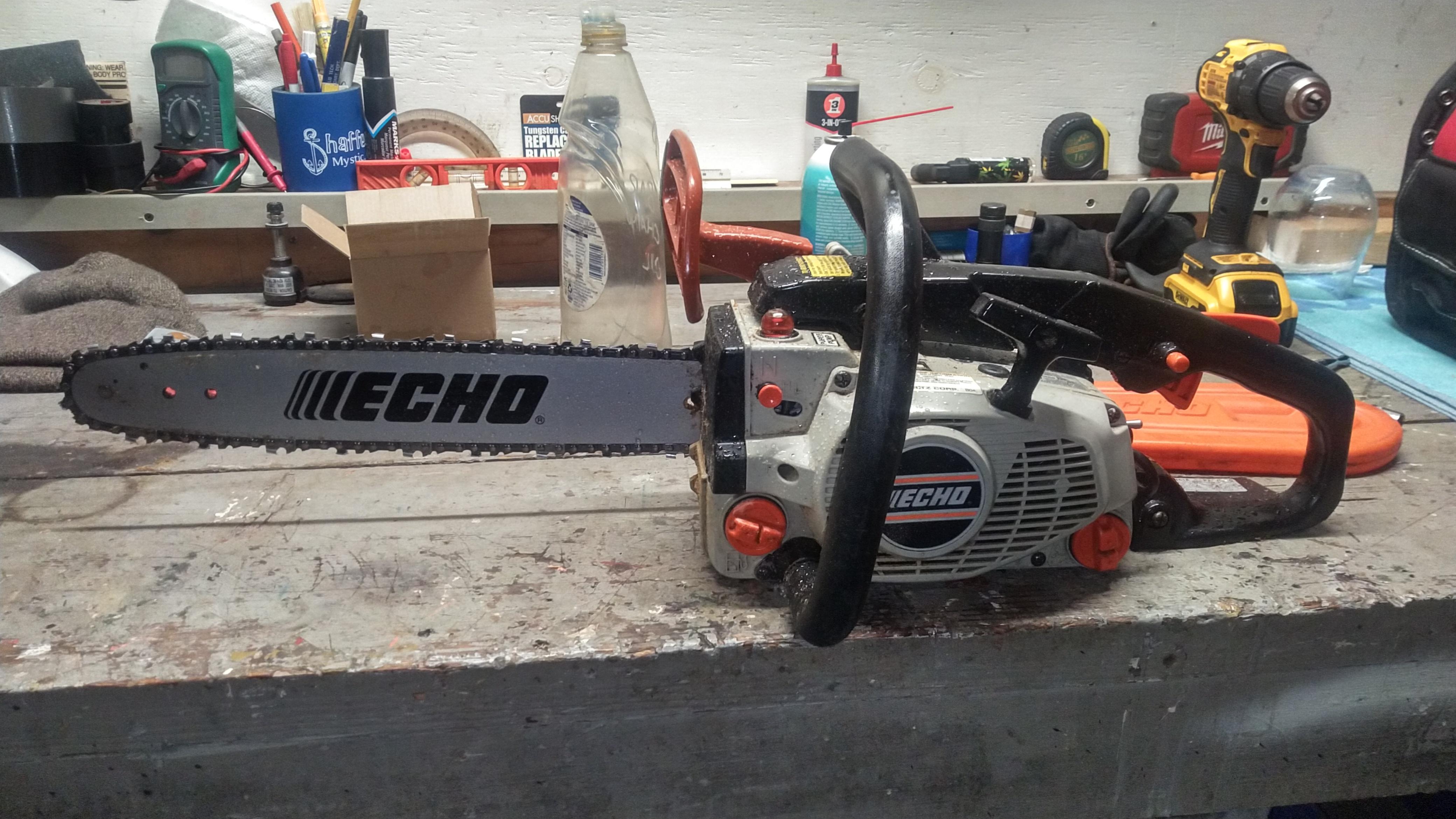

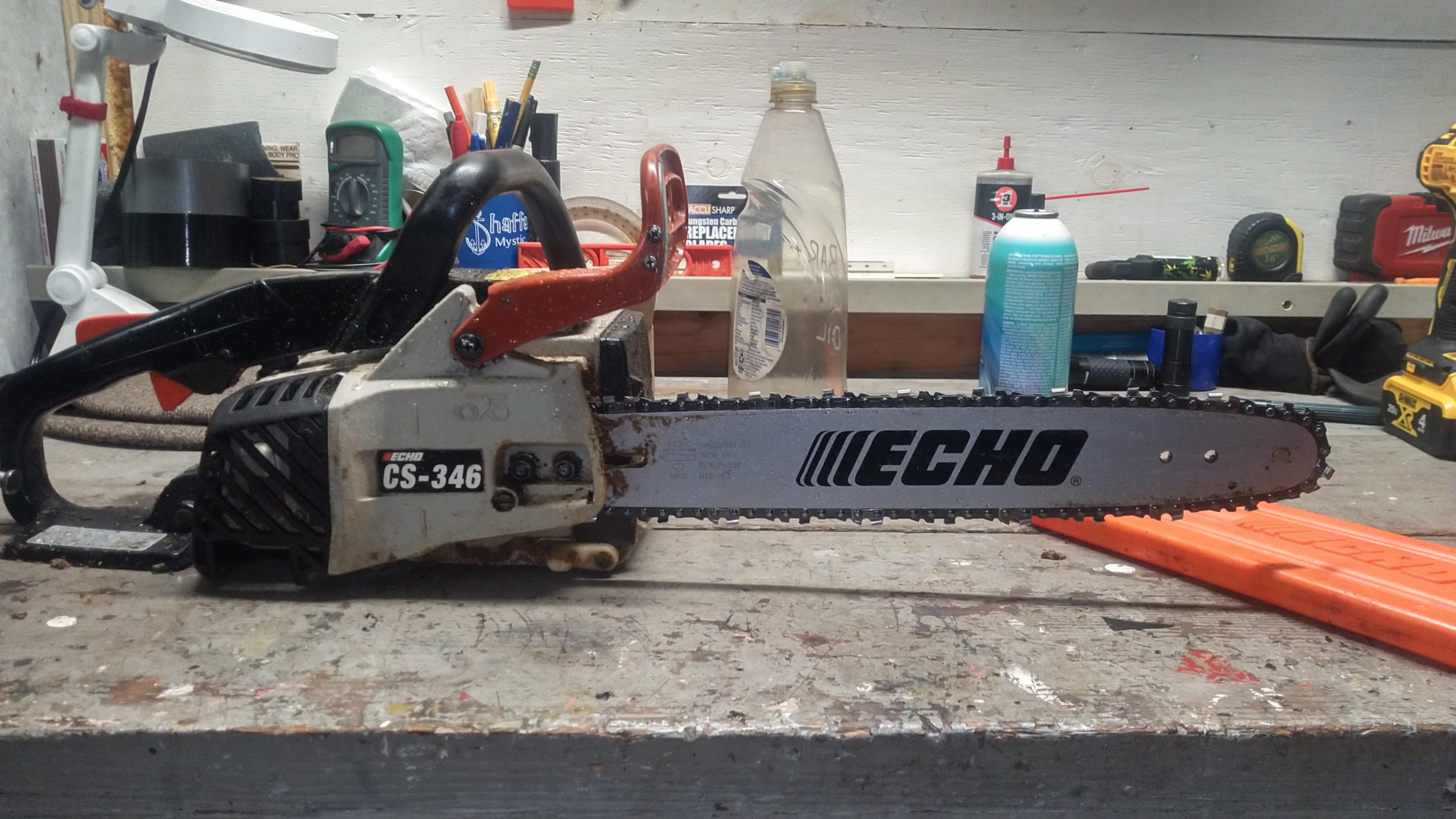

Echo CS-346. Quick tune up consisting of a new fuel filter and plug. Also removed and tossed the limiter caps. Waiting for the grommet that covers the needles and then she'll be for sale. Had to richen up the high side a bit as she was bogging pretty bad in the cut
