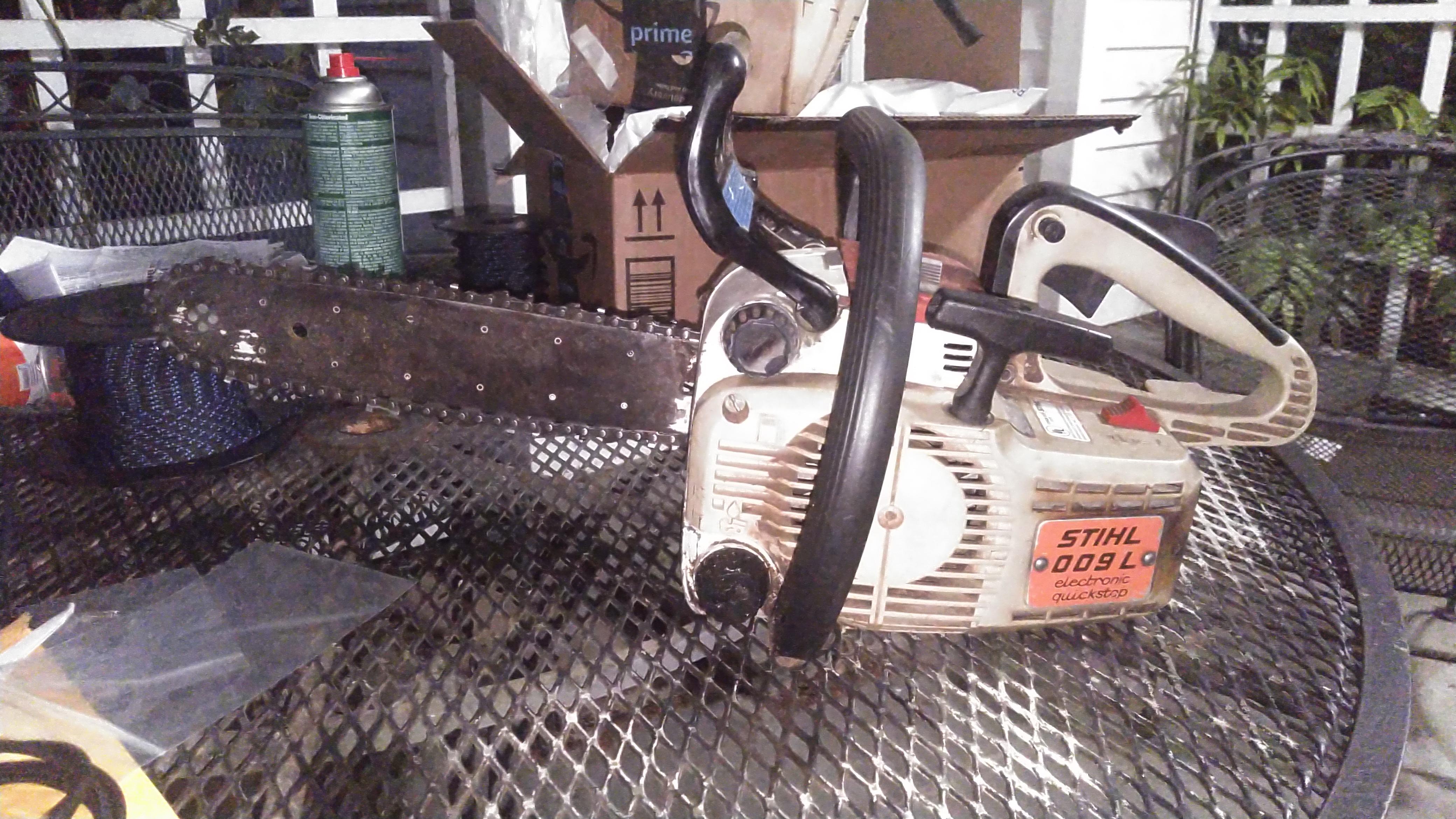

Finished up the 009L last night. Got the carb cleaned and rebuilt, fuel line and filter replaced, replaced the tank vent fitting and hose with the Echo style one, replaced the recoil rope and plug. Fired up pretty easily and got the initial tune done. Used it this evening to trim the arborvitae in the back yard and did the final tune on it. Runs good and it's getting picked up tomorrow evening.
