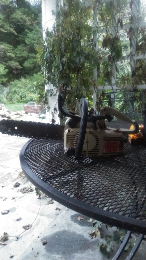

What? He did THIS on purpose? :eek:
I don't know what to tell You, I keep urging him to bring the saw/chain by whenever he is not using it - he just keeps saying "no need, still cuts great".
F-it, not my saw.
Even though, I am still the idiot that grinds off 2-3mm off all teeth each time he brings his chain/saw to me.
I guess I am lucky I purchased my MAXX PRO grinder, considering I used to file all chains!
I don't understand how someone responsible for providing required annual firewood for 2-3 decades and doing so by felling, limbing and bucking standing trees doesn't know what a sharp chain is!
People mock me when I make a couple bucking cuts, hit some embedded dirt and stop cutting because "the chain is dull".
Yet their yaws drop to the ground in disbelief when my saws make straight cuts through large diameter logs barely dropping in cut rpm and me NOT even touching the logs with my saws bucking spikes.
Each to their own, but I am getting sick of other peoples so called "knowledge" and I am in the process of cutting ties.
Life is to short and busy to endure others bulls#it!
The chain is still with me, I'll get "after" pictures.

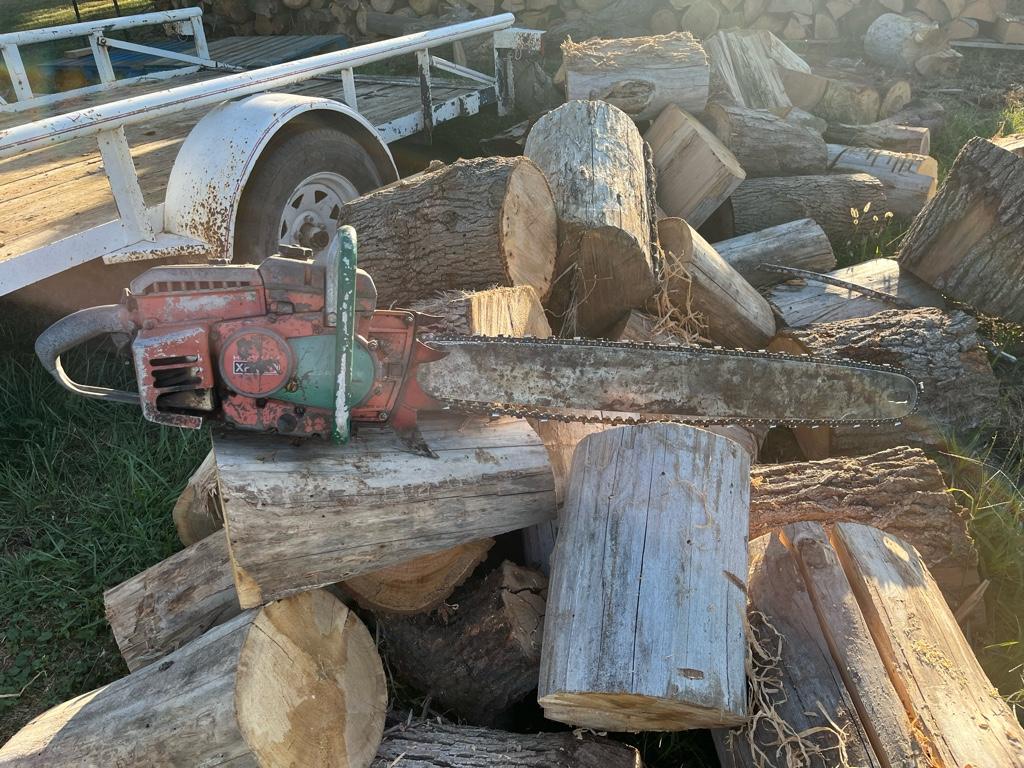

009L for a little love. Carb kit, fuel line and filter, tank vent and hose, spark plug and recoil rope
