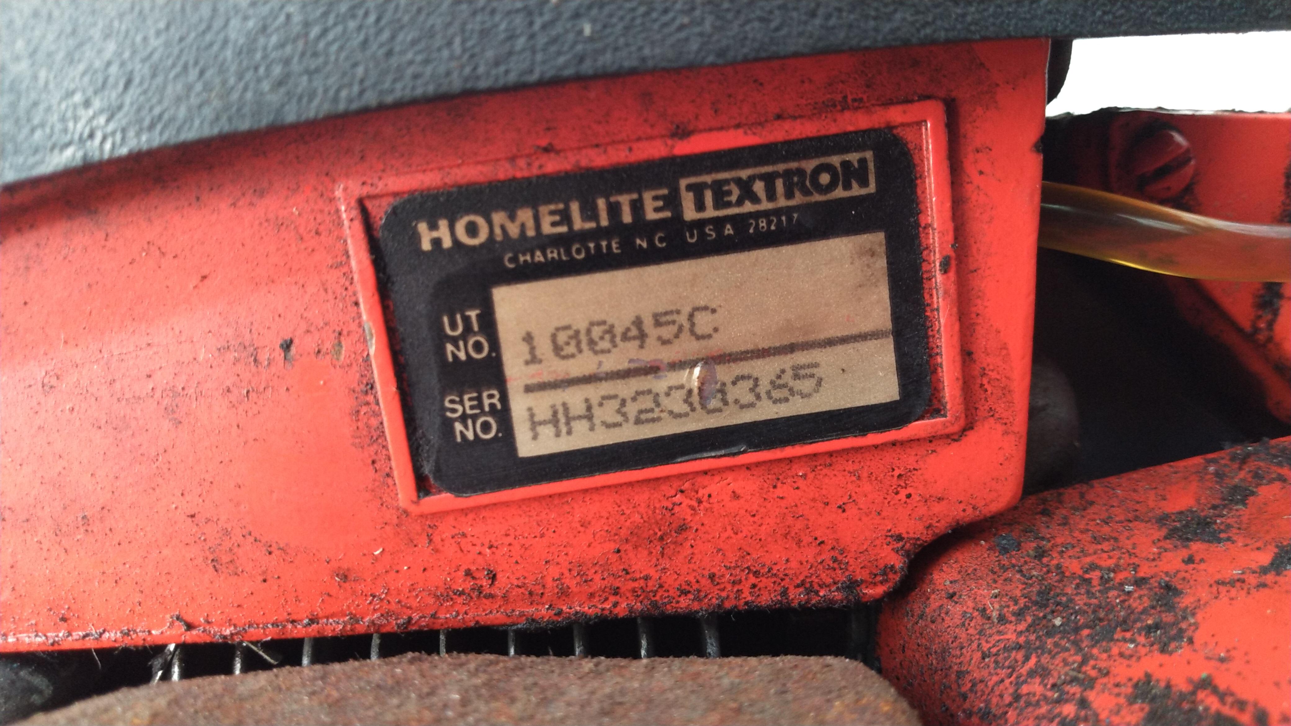

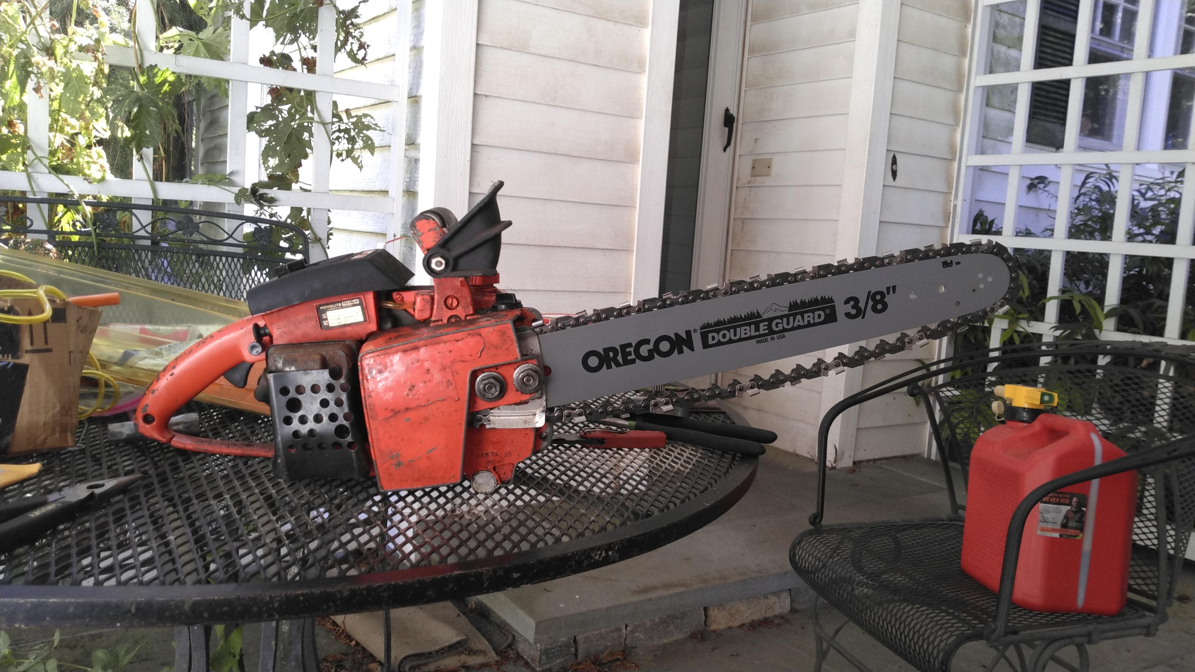

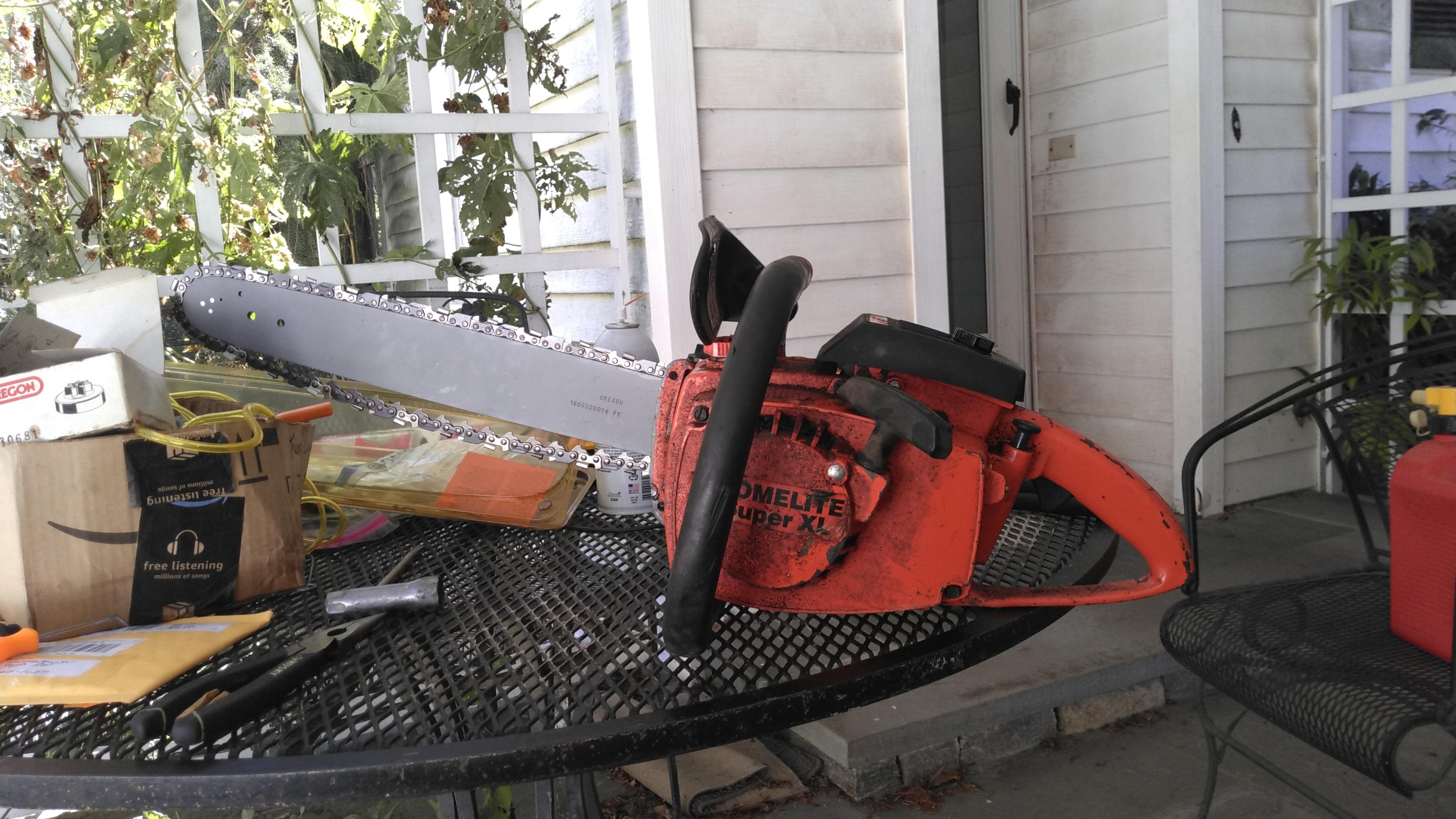

Homelite Super XL Automatic, got it running for a friend of mine. Didn't take much. Replaced the fuel line and filter, new plug, and air filter. Also replaced the sprocket, bar and chain which my friend supplied. Just need a tensioner which will be here next week so I can test cut with it.

I went through a couple of mine last year Will, removing the baffle in the muffler helps the power and really didn't make it too much louder.
