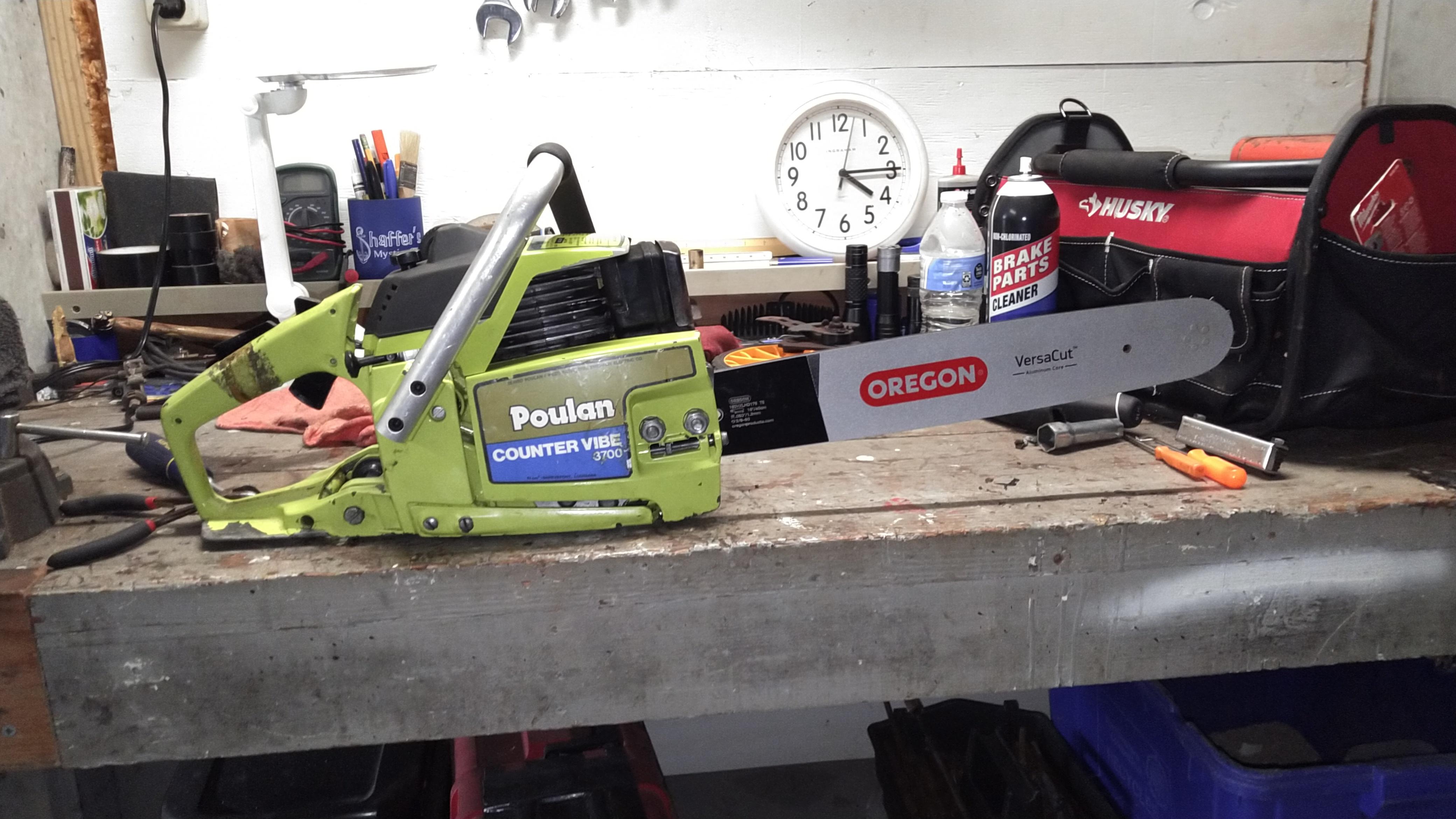

Found this in the shop the other day. Guy didn't want to fix it so he let me have it. Getting a fuel system overhaul so new fuel line, fuel filter, tank vent and carb kit as the diaphragms are pretty crispy. Cleaned up nicely too. New air filter and gasket on the way too. Seems pretty healthy and popped on mix down the carb.

Hey Will these ara a great all around saw! I definitely would share that a muffler mod is really needed with these though, they really choke without it.
Nice score , you suck.
Hehehe thank you!
What's the most common muffler mod?
