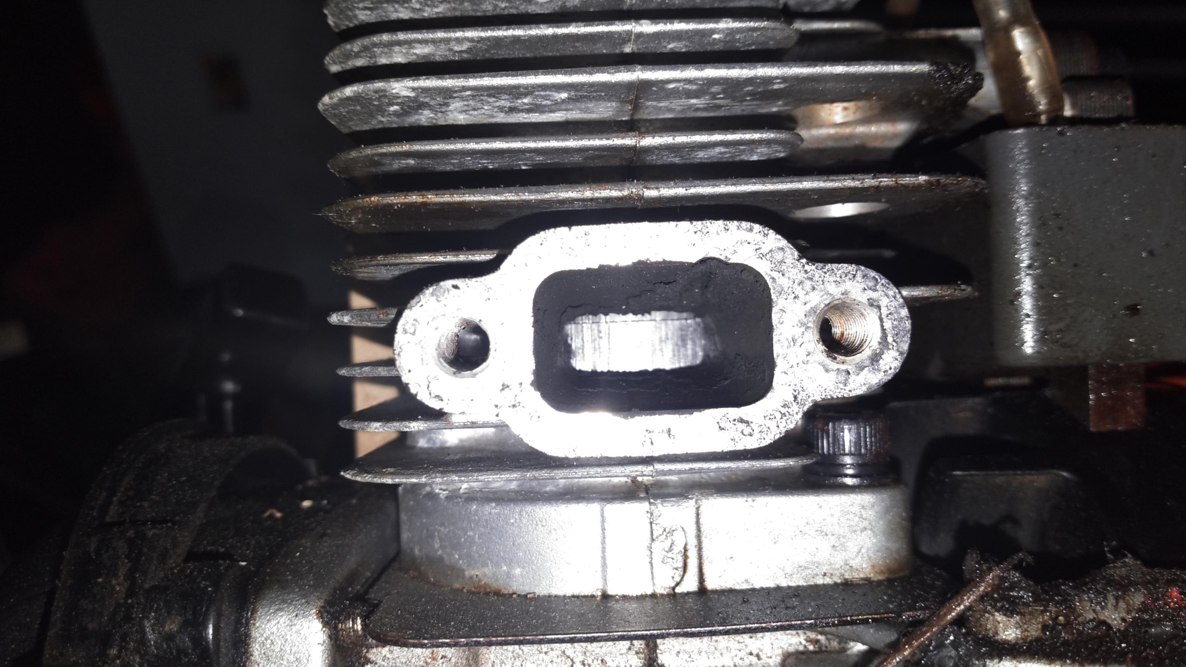

A fellow brought this in on Friday, said it just sputtered and quit. I was able to get it to start on a prime but it doesn't seem to pull fuel on its own. I disassembled the carburetor and nothing seemed too bad. Fuel line is attached and the fuel filter looks to be good. Compression is only 60 PSI, I did check the valve clearances and they are O.K.
I am open to suggestions including telling him to get a new one.
Mark
4 mix wants 75psi to run right.
I have 3 or 4 around here that came to me not running right with 50 to 60 psi.
Carb kit , a set of rings and clean the valves/carbon. Look at the plastic cam and adjust.
They now have 75 to 80 psi and run good, if a 4 mix can be classed as good running.

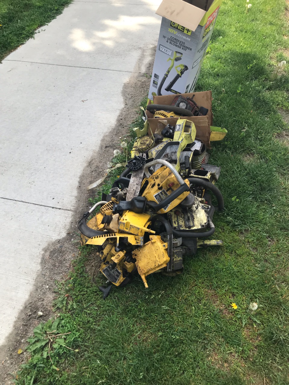

My mini mac is finally complete. It was missing on/off switch and the wire part for the oil pump. Had to take this whole pile of stuff to get my switch lol. I think ther is another complete mini mac in ther too so that will be another project.

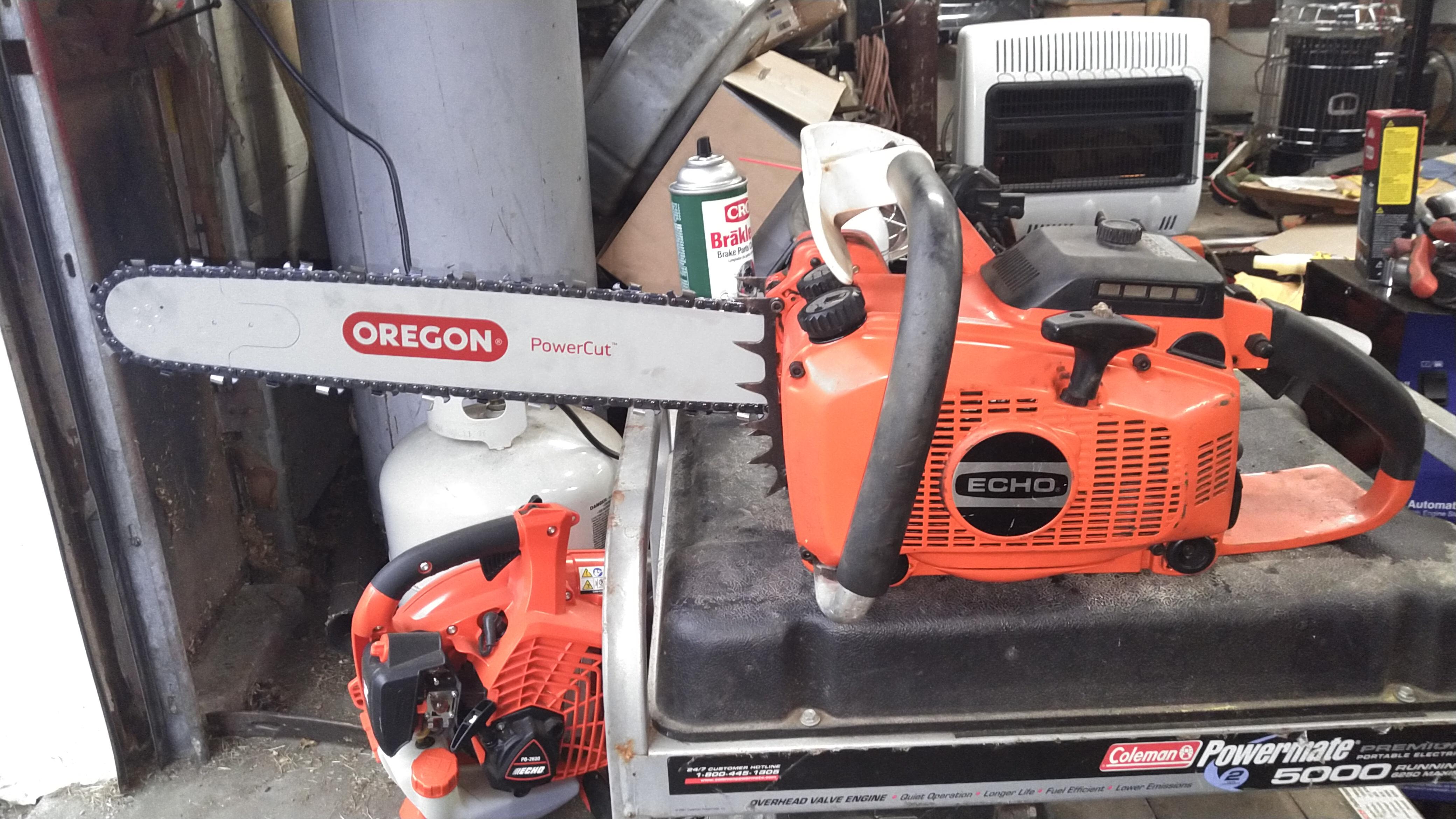

CS660-EVL ready for a test drive. New 20" Oregon Powercut bar and EXL chain. Fired up pretty easy, had to richen up the slow speed needle a tad and then bump up the idle speed. High speed adjustment seems good but will check it in the wood. Tossed in a new plug and fuel filter too. Air filter got blown out. Guy steam cleaned it before bringing it to me.
Sorry I came up empty handled on your switch. On the positive side you have a nice pile of magnesium firewood there.
