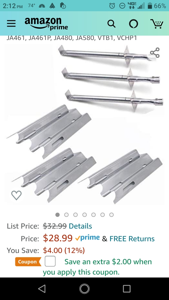

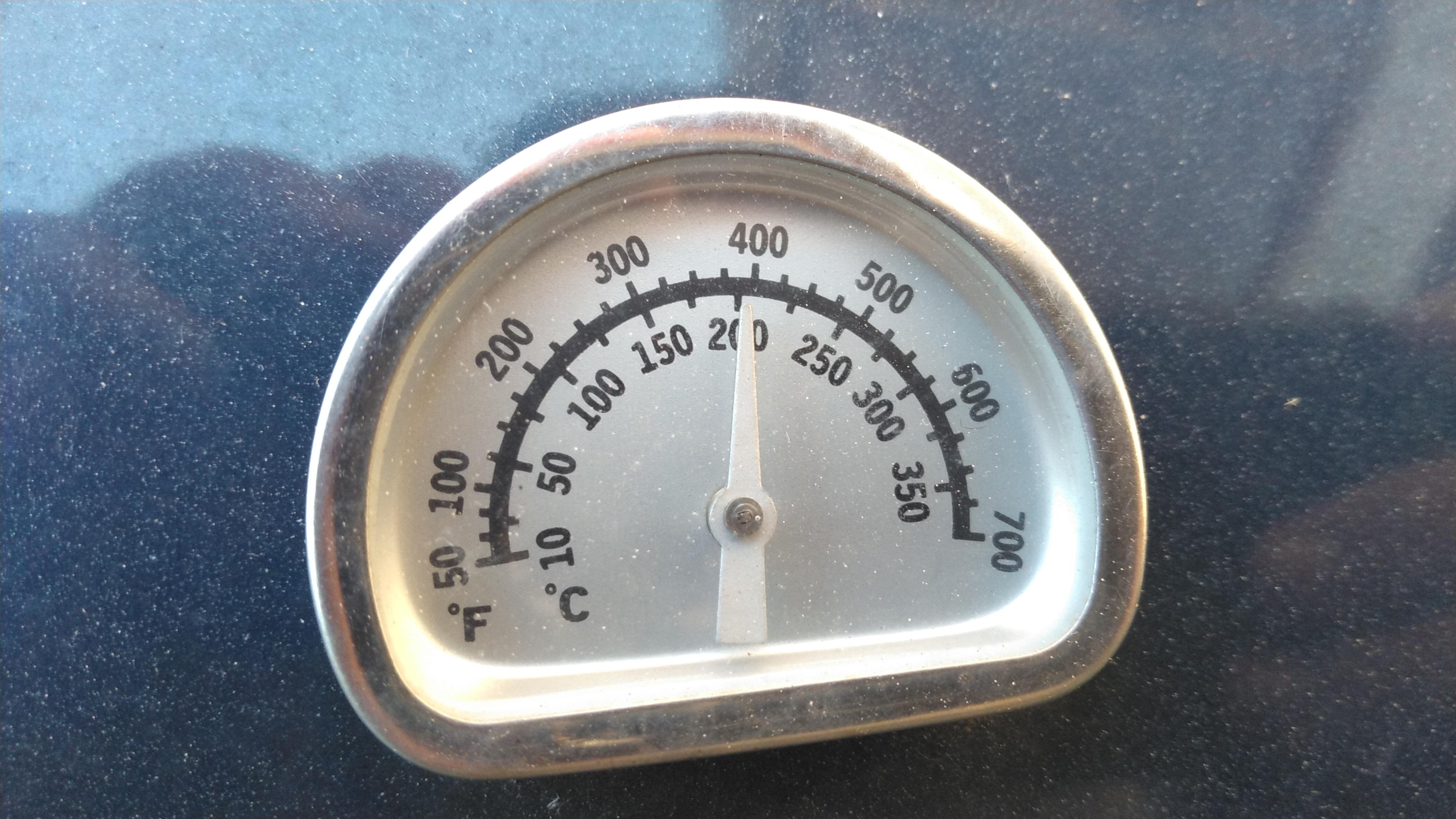

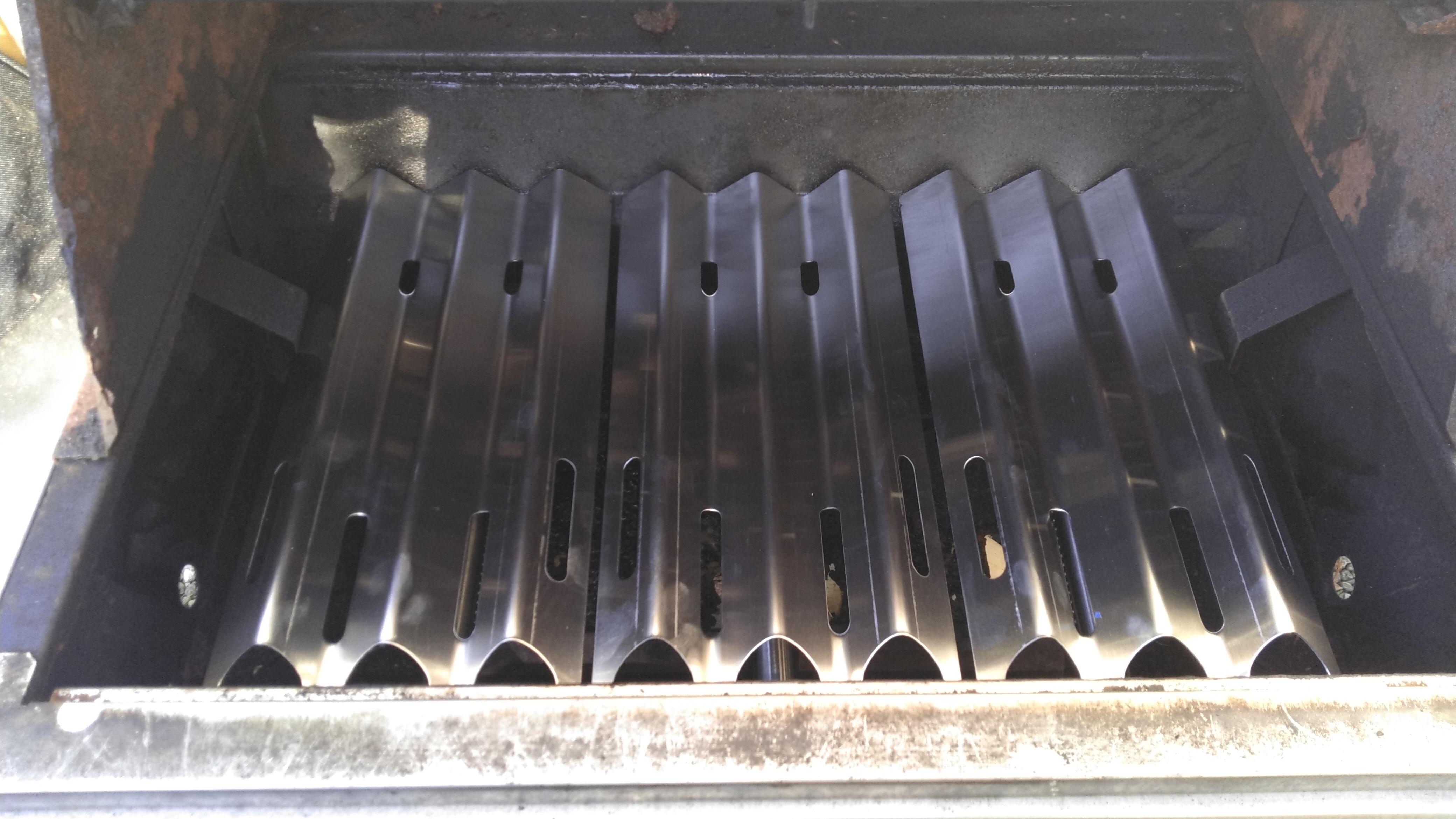

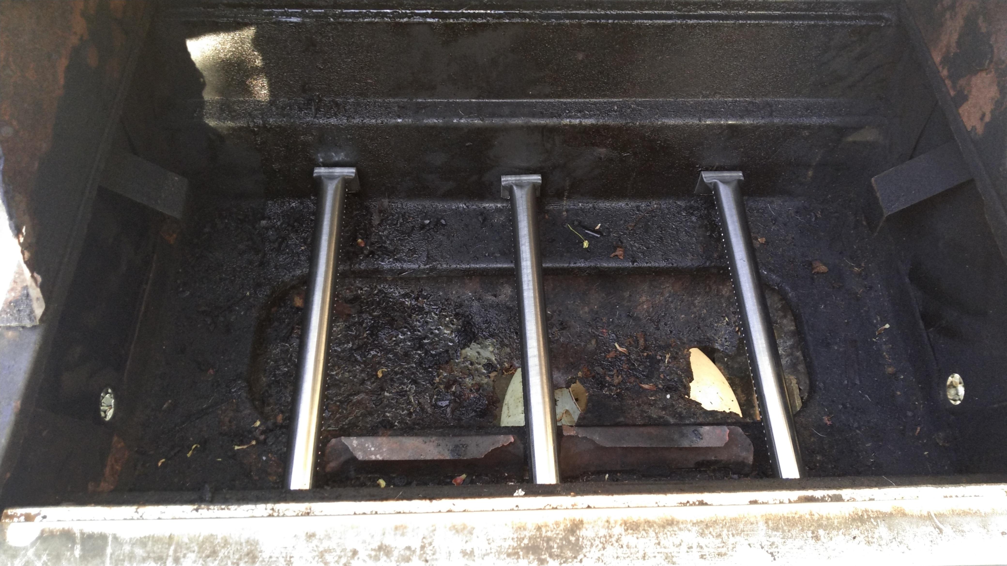

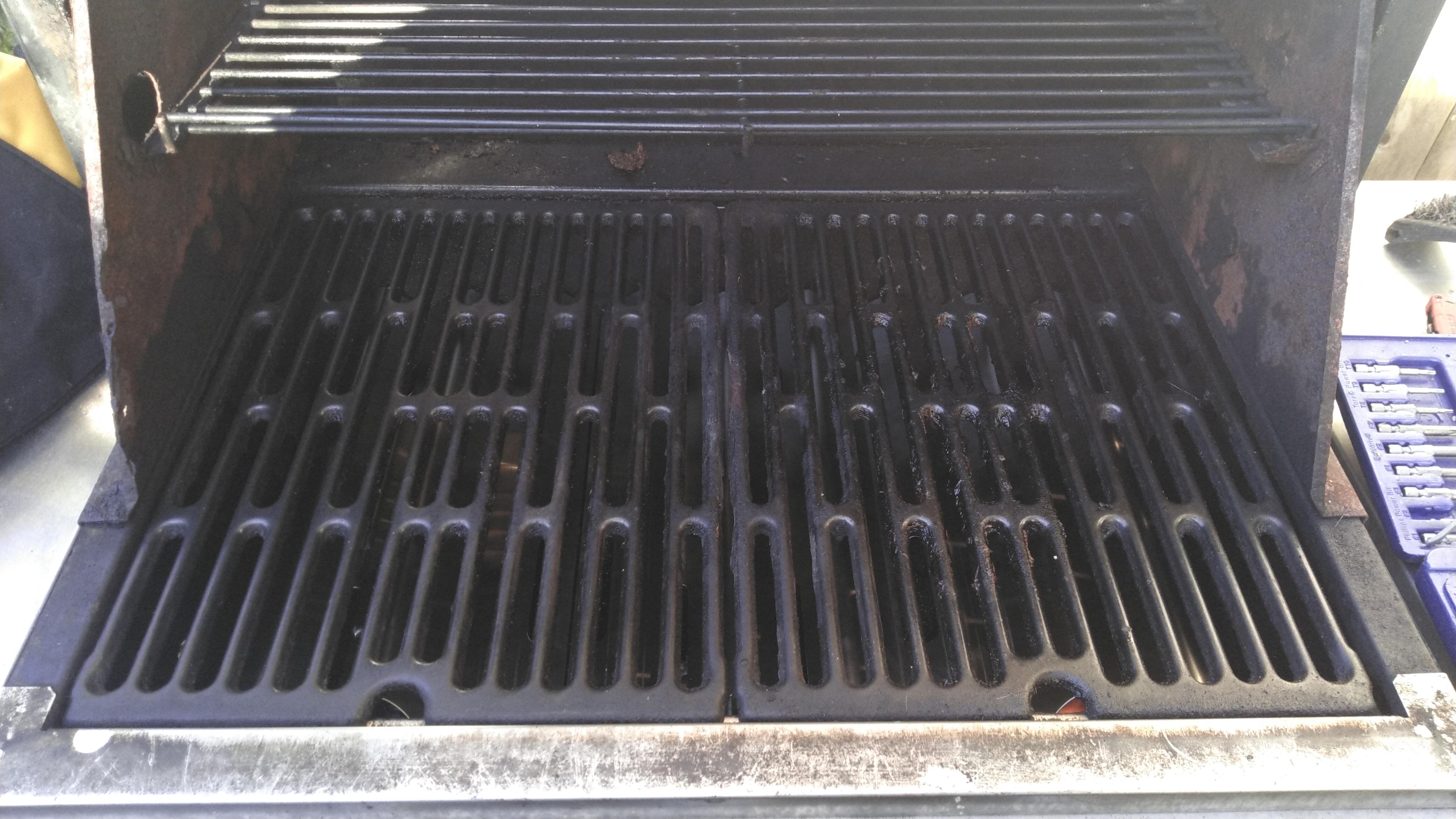

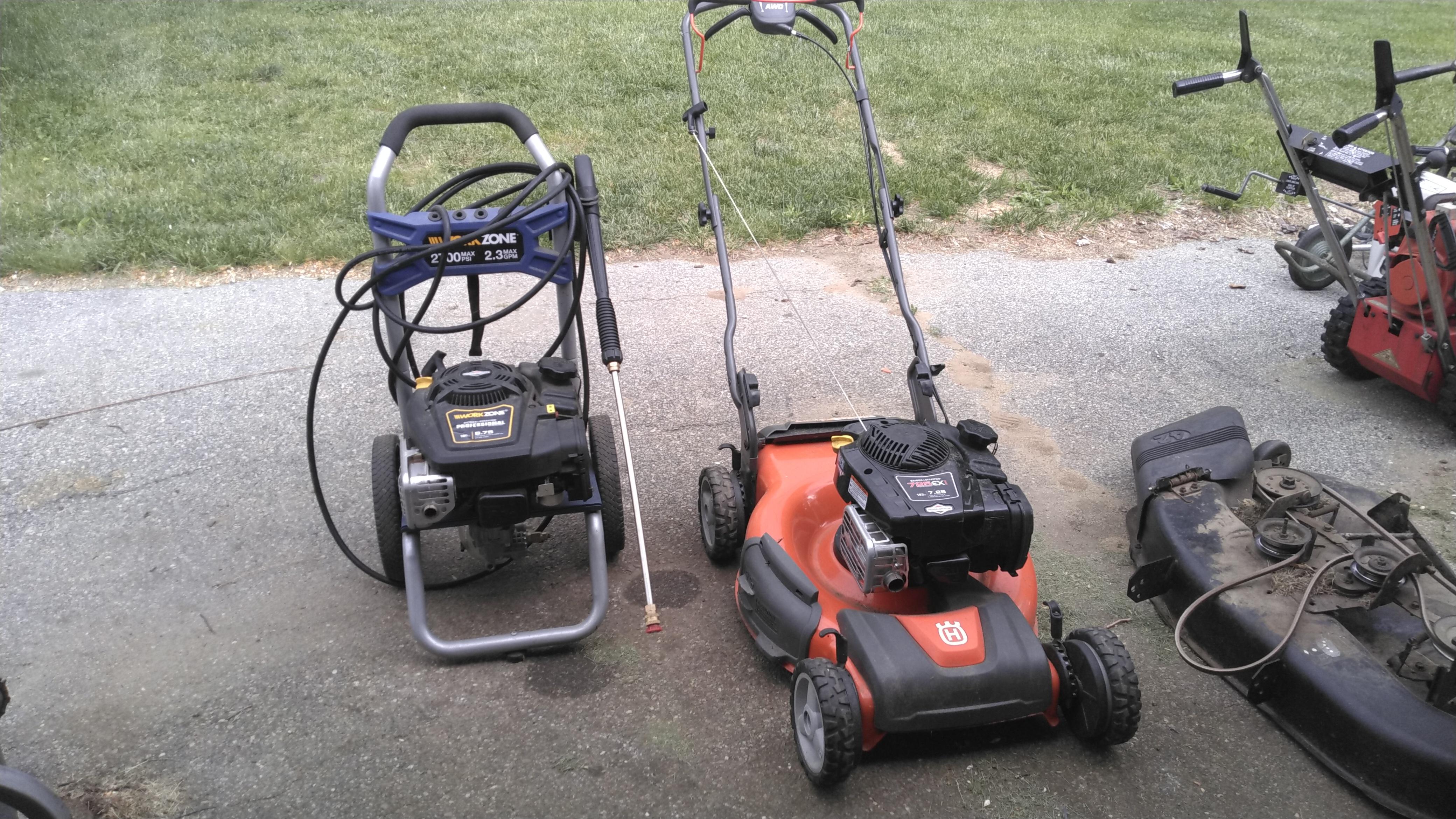

Picked these up this morning. Both are no starts. Both fired on carb cleaner. Should be straight forward carb cleans and fresh fuel. Gonna rebuild dad's Vermont Castings grill later on with new burners and heat tents. The push mower is a high end one with all wheel drive.
